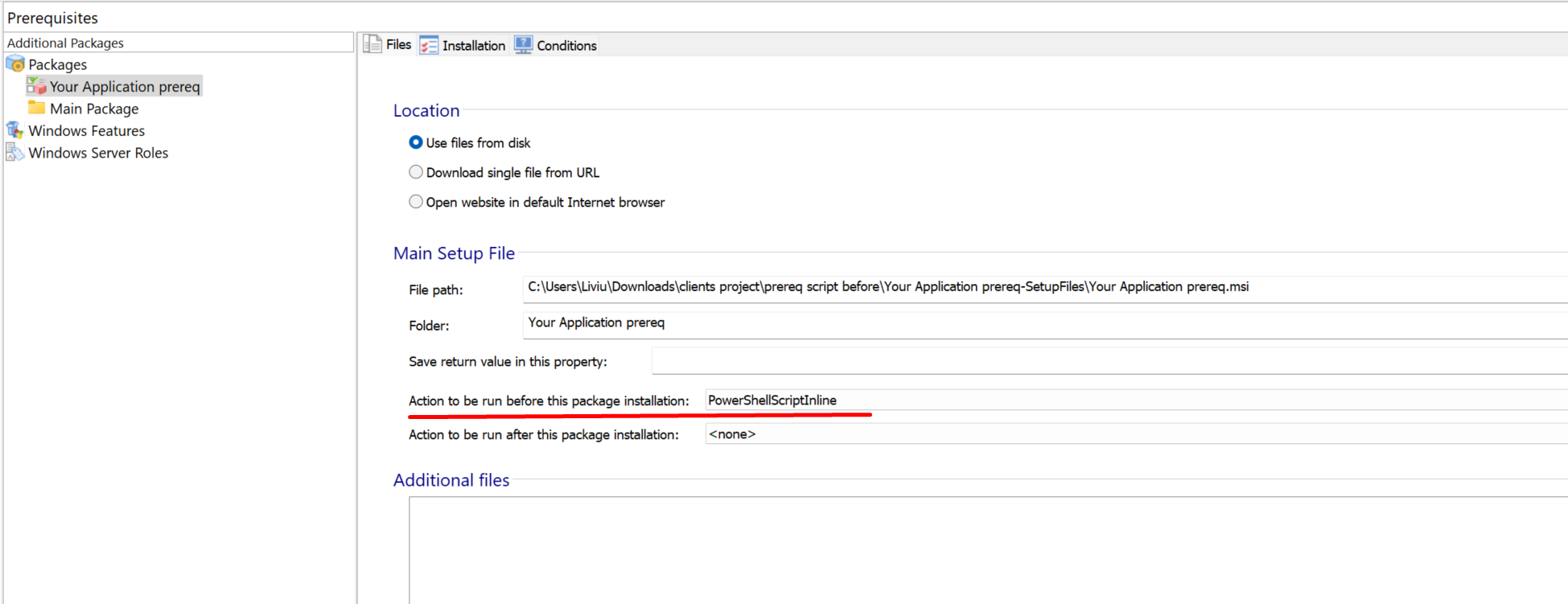

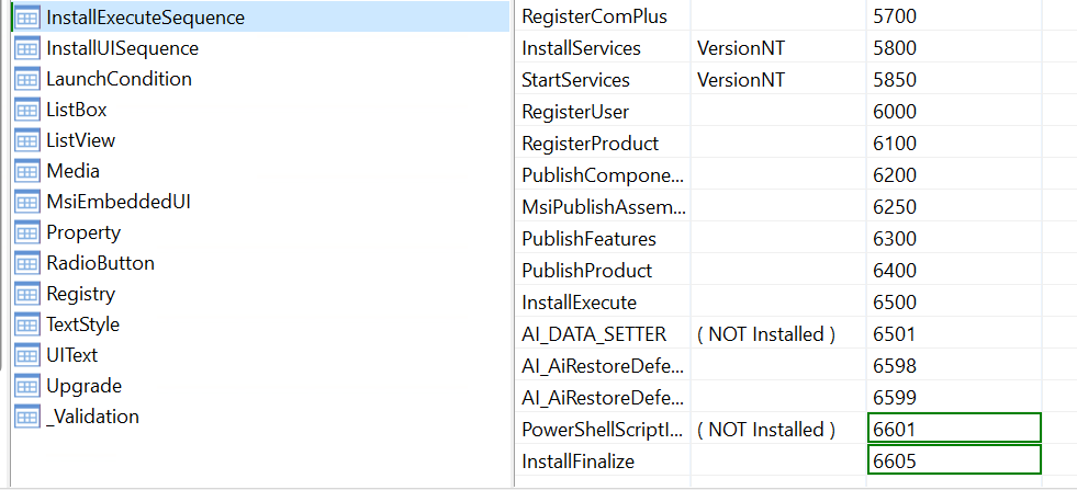

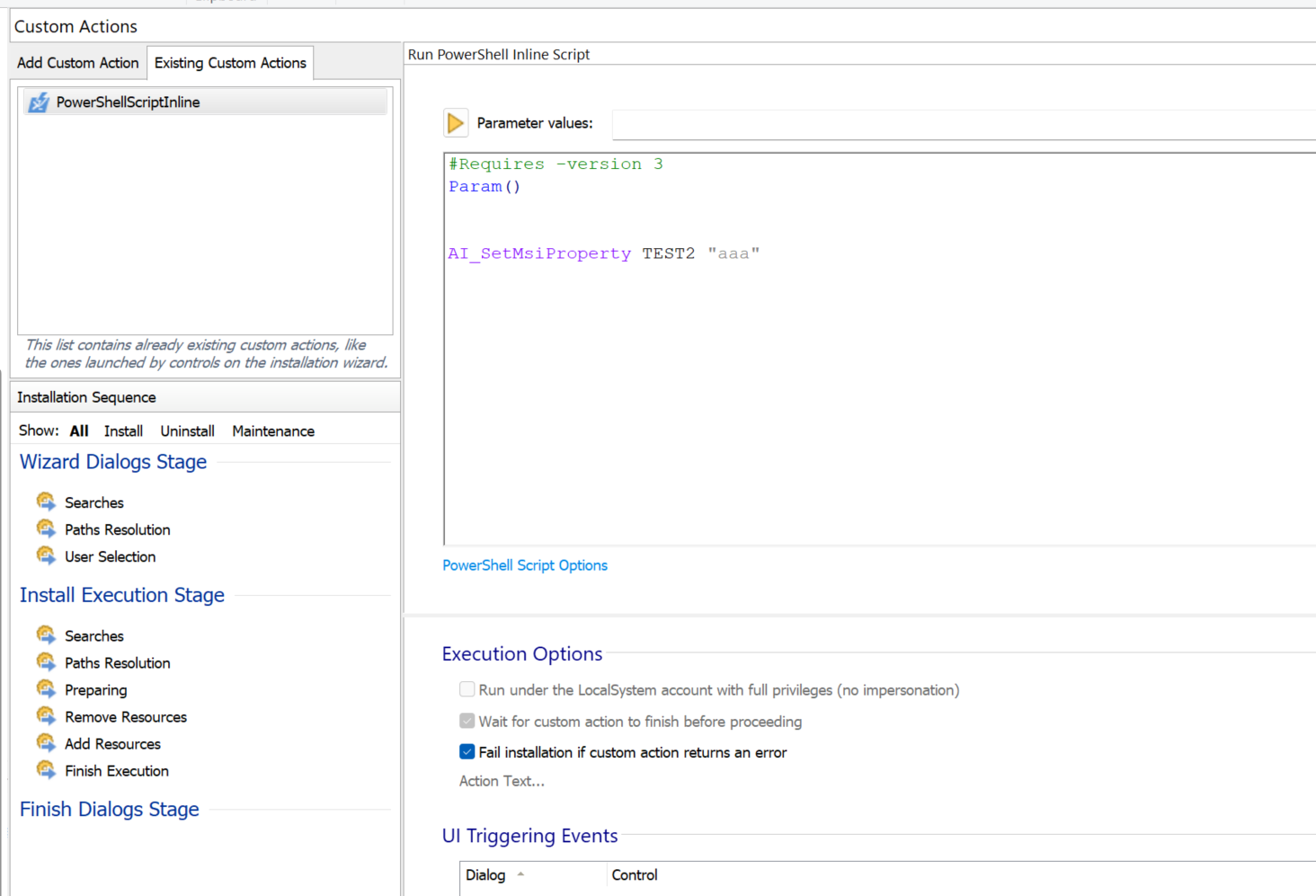

In our latest versions we've added support to run an action before the prerequisite installation.
I've tested this with a sample project using v21.7.1 and everything works as expected.
Please see the screenshots below:
custom action.png (198.85 KiB) Viewed 4525 times
Attached you can also find the two projects (prerequisite and main setup). Can you try this implementation with our latest version and see if it helps?
