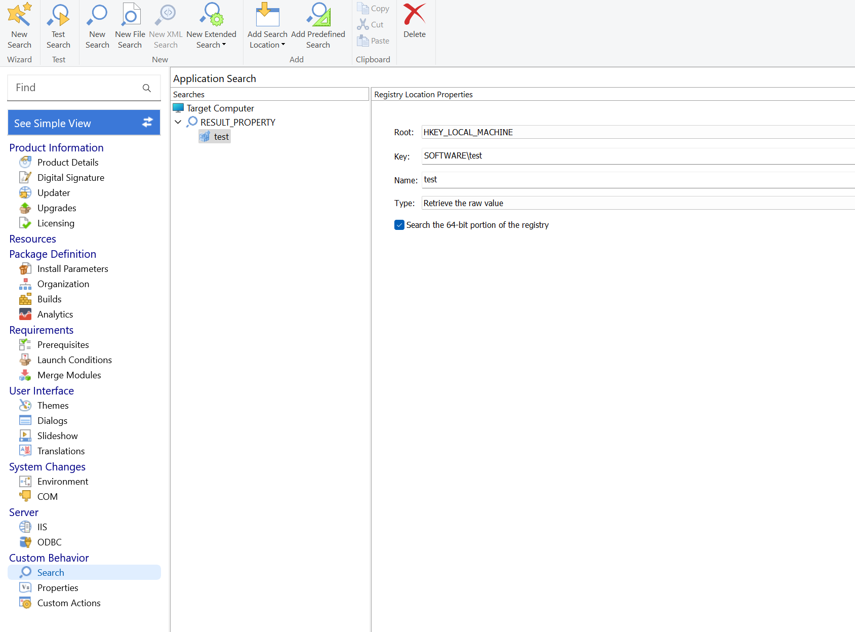

To check a registry entry, you can use a Search.
1. Go to the Search page.
2. Click on the New Search.
3. Click on the Add Search Location --> Registry.
4. Configure your search to retrieve the desired key value:
search registry.png (105.73 KiB) Viewed 13642 times

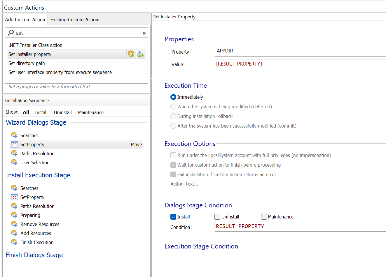

5. Go to the Custom Actions page.
6. Add a Set installer property custom action with sequence:
Property: APPDIR
Value: [RESULT_PROPERTY]
7. Hold the SHIFT key and drag it after the Searches action under the Wizard Dialogs Stage.
8. Add the RESULT_PROPERTY condition.
custom action.png (74.09 KiB) Viewed 13642 times
After that, if the registry key exists, its value will be used for the installation path, otherwise the default value will be used.
