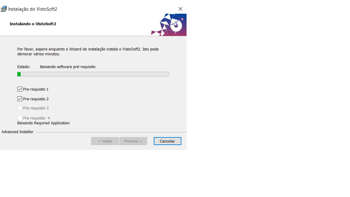

How to create a dialog that shows the installed requirements and checks them dynamically
Dears,
I want to create a prerequisite dialog that one by one shows the prerequisite and shows whether it is currently being installed while the progress bar advances. is this possible?
Re: uninstall old setup.exe software
Hello Rodrigo,
The prerequisite dialog is usually displayed before the actual prerequisite installation.
That means that we can not show the dialog with the prerequisites as well as the progress of the prerequisite.
This is the default behavior of most installlation packages.
You can do something like in your dialog, but it's quite hard to refresh the dialog in order to check/uncheck said checkboxes (yes, the dialog needs to be refreshed so that it changes the state of the control).

Normal behavior:
1 - a dialog showing the prerequisites that will be installed
2 - a progress dialog that I only interact with when it finishes downloading the entire pre-requisite
what I'm wanting is:
In the progress dialog, with each installed prerequisite I check/uncheck the prerequisite and show it dynamically in the dialog.
is this possible? Is there any similar example?
the dialog needs to be refreshed to change the control's state. but where do I do this?
Rgs,
Rodrigo
Hello Rodrigo,
I'm afraid that what you want to achieve might not be possible.
However, we can do something similar. For instance, check the following article:
List main actions performed during installation into a user friendly log-like fashion
The above will show to the user the actions performed during an install.
