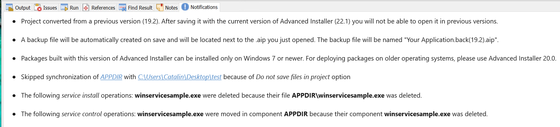

In our case, when we open the project in version 22.1, the files are removed as expected and the service as well:
