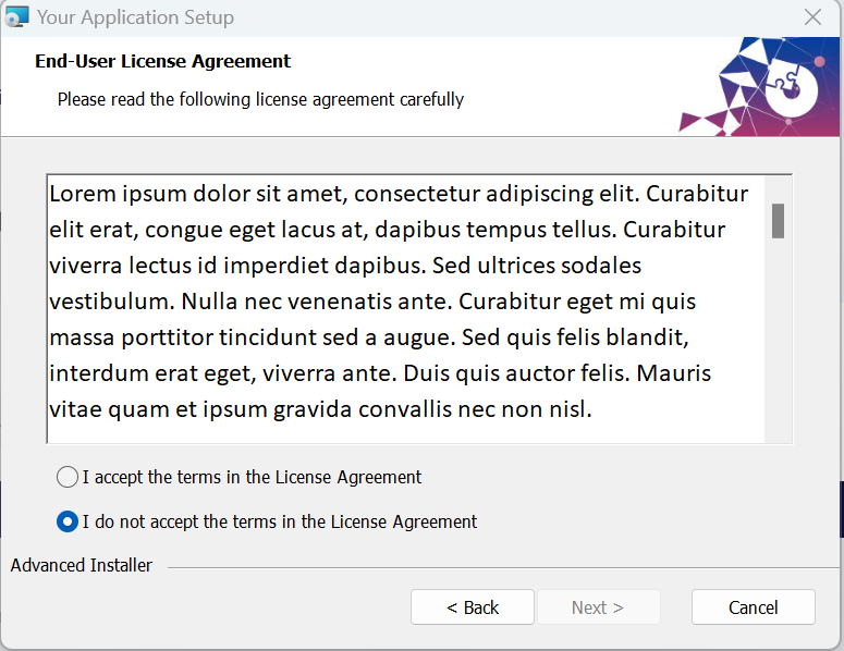

Isn't the EULA dialog (LicenseAgreementDlg) what you're aiming for?
It allows you to display your license agreement from a file and even enforce its reading. The Next button is enabled when "I accept the terms.." option is selected.
eula dlg.png (63.43 KiB) Viewed 5554 times
