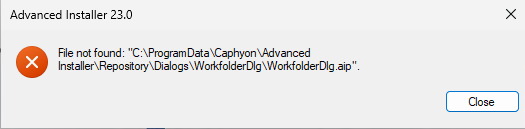

We have encountered an issue on Windows 11 Enterprise edition 24H2 version. We are currently using Advanced Installer 22.7
Some of our colleagues that upgraded from Windows 10 to 11, encounter an error message stating the Installer requires an active Internet connection.
In the Launch Conditions project tab we do not have enabled the 'Run only if an active Internet connection is found'.
What could be causing the issue? We are using some prerequisites and thought that maybe they're causing this issue, but if I create an installer without any prerequisites, the same error occurs.
I have attached a sample of the .aip project without any binaries, in case it helps.
Thank you!
project.aip
(130.77 KiB) Downloaded 167 times
Screenshot 2025-09-02 130436.png (45.26 KiB) Viewed 2678 times

That's right. Once we migrated from Win 10 to Win 11 this error started to appear. What's most interesting is that it seems to happen only on the 24H2 version of Win 11. 22H2 seems to be fine and does not throw this error.

From what I can see in your project, you also have a "WebBuild" that will require the internet connection, because it is a web-based installer (it downloads the files for you so it is smaller in size).
Could you please confirm that this is not the one that you are launching?
From what I can see, it is exactly that one that you are launching (from the screenshot in the first thread you provided).
I have built using dummy resources and opened the other two and it says "Welcome to APOGY Canvas Setup", while in your screenshot it says "Preparing APOGY Fashion Studio Setup", which is exactly the web build. :D

The application has gone through a name change, that's why the differences from the screenshot vs the installer now. The webinstaller has never been used but it remained there as an option in the .aip.
We're using the ExeBuild and ExeBuildNO3D builds. I wish the issue would've been caused by the web installer, but unfortunately that is not the case.

The issue is constantly reproduced on all 24H2 Win11 versions.
I am not entirely sure if it matters that the machine is a clean Windows 11 or it is just an upgrade from Win 10 to Win 11.
I know for sure though, that some colleagues had the Windows 11 22H2 version before upgrading to 24H2 and that's when the error started to appear.
