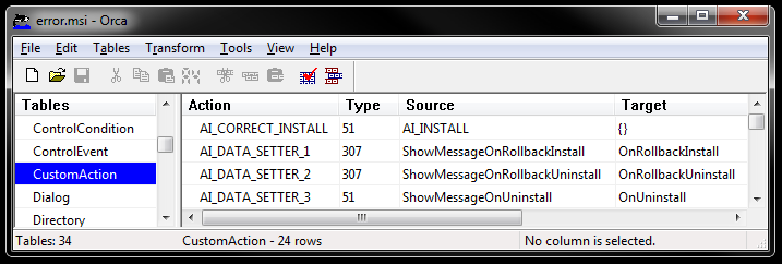

Let's look inside .msi with Orca again. Now we will observe "CustomActions" table.
Do you see ActionType for AI_DATA_SETTER_1? It's equals 307.
And for AI_DATA_SETTER_3 (setups CustomActionData for ShowMessageOnUninstall) it is 51.
What is 307? I think it is 256 + 51 = 307. Why it get there? It get there mistankenly. It's all about msidbCustomActionTypeRollback (Hexadecimal: 0x00000100, Decimal: 256). It has same value as msidbCustomActionTypeFirstSequence.
Because AI_DATA_SETTER_1 setups CustomActionData for ShowMessageOnRollbackInstall, and ShowMessageOnRollbackInstall is rollback (it has this type msidbCustomActionTypeRollback), Advanced installer errornously put this msidbCustomActionTypeRollback into type of AI_DATA_SETTER_1.
But msidbCustomActionTypeRollback works only when msidbCustomActionTypeInScript is defined (Action marked as deffered), otherwise it works as msidbCustomActionTypeFirstSequence, that prevents custom action from running inside InstallExecuteSequence.
Ok, let's do the main part. Edit .msi file with Orca, and change ActionType for AI_DATA_SETTER_1 into value of 51. (Same for AI_DATA_SETTER_2).
After this actions done everything works perfectly.
