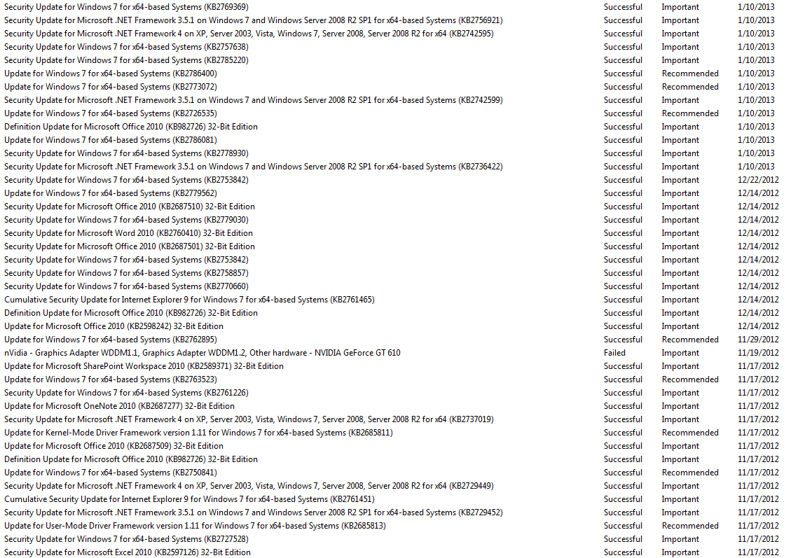

2) Do you have an NVidia graphics adapter, as mentioned on this Microsoft forums thread?
Bogdan

I do have an NVidia graphics card and it looks like I received the nVidia - Graphics Adapter WDDM1.1 update. The other machine in my office that we could create this issue on also has an NVidia card. I uploaded screen cap of the updates I received around when this issue occurred in case it helps. It also looks like this update failed. I pasted the error for this update bellow. I have restarted several times since the update. I will play with it a little more Monday.
