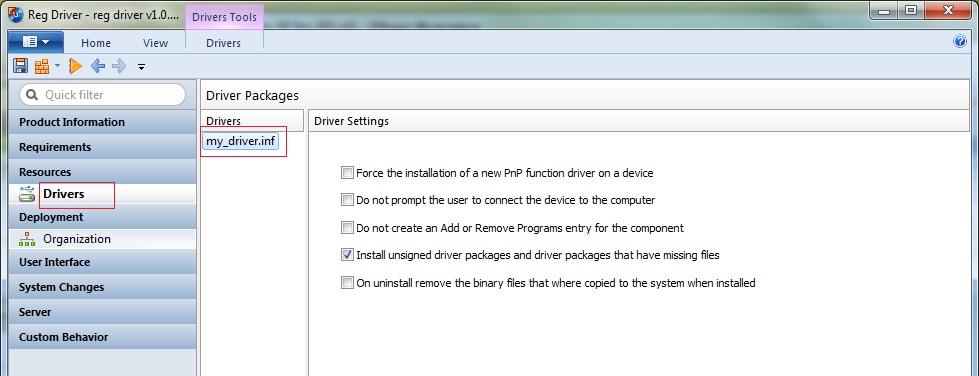

How to install a driver depending on the feature.
Hello! Help me please.
Why my driver is always install? While the INF file is in feature, which I did not install.
How to install my driver only together with a feature? Otherwise do not install.
Thanks.

Re: How to install a driver depending on the feature.
Thank you very much.
I am doing as you write, but if the feature1 selected "Not installed by default" - does not install the driver never. Even if the feature1 is enabled when you install msi.
Vice Versa. if the feature1 selected "Installed by default" - my driver is always install. Even if the feature1 is disabled when you install msi.
In the Installation Settings, the default value is: "Install the feature locally" not: "Run feature from installation source". Try this option and if you still have have an issue use the option " Use parent feature installation settings". If the problem still exists, please send us the .AIP (project file) and a verbose log of the installation to support at advancedinstaller dot com so we can investigate them.
Thank you very much, Dan.
The option " Use parent feature installation settings" + the option "Always install this feature." gave the desired result. :D
Although it seems to me that it's not very logical.
