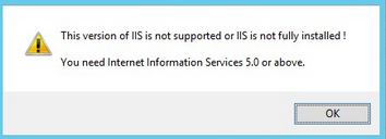

I have Advanced Installer v10.8 build 54215. I have checked IIS windows features as on attached screenshots. Uninstall policy was "Do not remove installed features"
When I install on Windows Server 2012 R2 I get error.
Logs:
MSI (s) (60:28) [17:01:49:604]: Invoking remote custom action. DLL: C:\Windows\Installer\MSI5F5B.tmp, Entrypoint: OnIIsConfig
MSI (s) (60!FC) [17:04:44:614]: Product: <My ProductName> -- Error 4023. This version of IIS is not supported or IIS is not fully installed !You need Internet Information Services 5.0 or above.
MSI (s) (60!FC) [17:04:45:870]: Product: <My ProductName> -- Error 4020. There was an error during the IIS configuration process. Your original IIS configuration will be restored.
MSI (s) (60:BC) [17:04:45:886]: Note: 1: 2265 2:  3: -2147287035
MSI (s) (60:BC) [17:04:45:886]: User policy value 'DisableRollback' is 0
MSI (s) (60:BC) [17:04:45:886]: Machine policy value 'DisableRollback' is 0
When I go to Control Panel->Programs and Features->Turn Windows features on or off, then click "Add roles and features" and go to IIS features(in Windows Server 2012 R2 it calls Server Roles) I see that choosen IIS features wasn't installed.

Internet Information Service 5.0 was already disabled from the Software Launch Conditions. Error appears not at start of installer, it appears at the end of instalation(on IIS config). Problem is that all those features I selected at Prerequisites->Windows features does not install in Windows Server 2012 R2. At other OS(e.g. Windows 7,8, Windows server 2008) it works OK.

You might get this behavior on a Windows Server 2012 R2 and on Windows 8.1 due to a bug in Advanced Installer, where the versionNT is not correctly detected (it has the same value as the one for Windows 8 and Windows Server 2012) when the Enhanced User Interface is enabled. Here's the Bug! for Windows 2012R2 VersionNT64=602 forum thread which debates this subject.
I've attached a zip archive which contains the fixed resources (ExternalUi.exe and setup.exe). So, can you please replace the resources from the installation folder of Advanced Installer (e.g. C:\Program Files (x86)\Caphyon\Advanced Installer 10.8\stubs\x86) with these ones and see if the behavior still persist. Also you should back up first your original files.

Yes, thank you it helped. It means that I have to update advanced installer to 10.9?
Re: Windows Server 2012 R2 IIS is not fuly installed
Hi Alex,
The fix for this issue has been included in the 10.9.1 version of Advanced Installer released on February 10th, 2014.
If your Maintenance Plan is valid, then you can upgrade to the latest Advanced Installer version.
