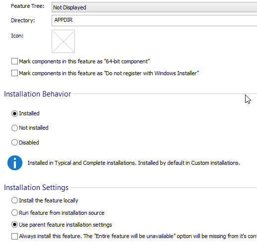

The hidden sub features are setup up like this:
2015-04-17 11_50_39-TheCommonSetup.aip (English US) - Advanced In.png (16.38 KiB) Viewed 16978 times
To summarize my experience:
  • First time installation of setup, with "C" and sub features: only "A" and "B" is installed, but "A1" and "A2" is missing
  • Modify installation: remove "C" again - "C" including all A's and B is removed
  • Modify installation: add "C" again: "C" is properly installed, including all A's and B
Somehow I have a weird dependency between "A" and "B", which I don't want to have. Have you ever heard about a similar problem? How do I solve it?
