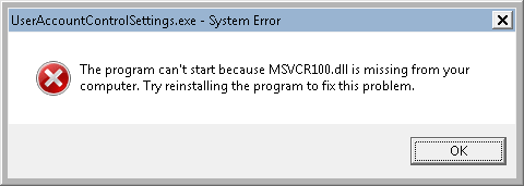

Hi Team,
Failed to register a file (.OCX) when use "extract info from native library" option under file properties.please find the below attached screen sorts for reference.
please revert, if you have any clarifications.
Pradeep

HI Team,
As my understanding issue come up from User Account Controls settings.
we found the dll from system 32 & "C:\Program Files (x86)\Caphyon\Advanced Installer 11.7.1\bin\x86\msvcr100.dll"path specified.
Pradeep.

hi team,
am able to register the file (.ocx) manually. i found there is a problem with UAC or the .ocx may have some dependencies to register from the tool (Advanced installer). Please provide the resolution to overcome this issue.
