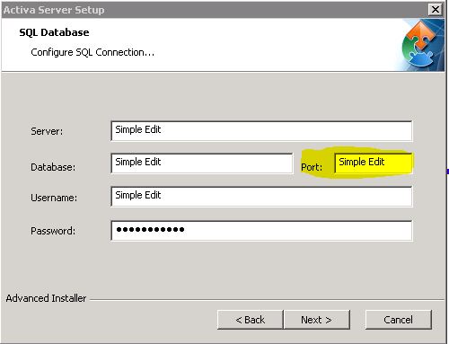

I have been working on this but do not see any way to use existing property as I am already requesting a user to enter SQL Server IP, Database name, Username, password and Port details during the installation process. It would be much easier if we can use the existing property for Check TCP port function as well. This could be the same for Host name or IP field as well.

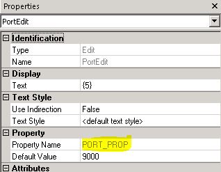

During the installation process, I am requesting user to enter PORT(PORT_PROP) details which is going to be used by the borland socket server once the service is installed. So when I already have the port and Server details in my installation step, why can't I use the same Port details to check whether this port is available or not? Currently, when I try to use existing property from SQLConnectionDlg for TCP port check, it does not allow me to select any (Only accepts manually entered value). Please see attached screenshots.
Hope this makes sense. Thanks!

Indeed, you cannot use a property in the "Check TCP Port" custom action. If you want to check for a port that the user types you need to use the predefined "AI_SEARCH_TCP_PORT" property instead of "PORT_PROP" or you can create a "Set installer property" custom action that sets the "AI_SEARCH_TCP_PORT" property to the value of the "PORT_PROP" property.
