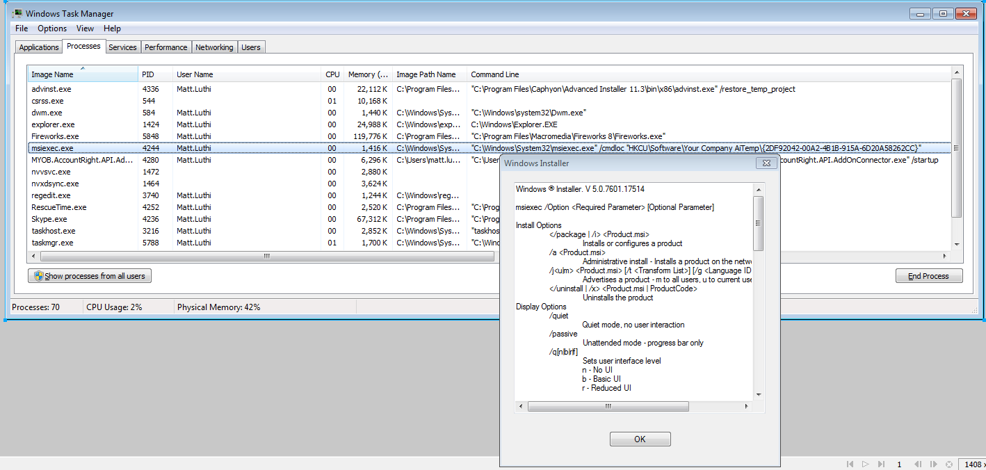

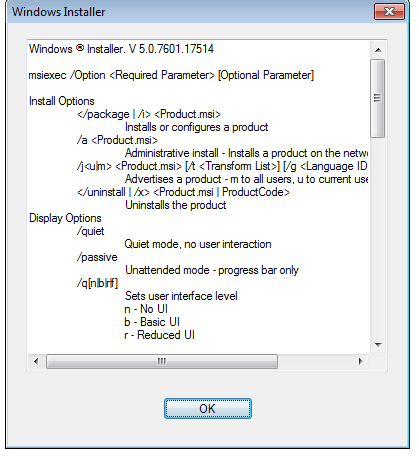

Hi Dan, thanks for your help so far. But it turns out that your sample project is not properly working. I am getting an msiexec popup after EVERY reboot following the installation of your sample project. It seems that when the helper installer causes the reboot to happen, the main installer is left in an incomplete state. It leaves entries in the registry to start up on reboot but these fail. I tested this on other computers as well with the same result. The reason I only found this out now is because I never clicked "ok" to actually reboot before.
Please review the attached files for further details. It appears that on login after a reboot, msiexec is called with a "/cmdloc" flag to instruct it to obtain the parameters from a registry key but I have not found this flag anywhere on the microsoft installer documentation.
Full registry run command params:
/i "C:\Users\matt.luthi\Downloads\Sample\Sample\MainPackage\MainPackage-SetupFiles\MainPackage.msi" AI_RESUME=1 ADDLOCAL=MainFeature,YourApplication ACTION="INSTALL" EXECUTEACTION="INSTALL" ROOTDRIVE="C:\" AI_PREREQDIRS="C:\Users\matt.luthi\AppData\Roaming\Your Company\Your Application\prerequisites" TARGETDIR="C:\" APPDIR="C:\Program Files\Your Company\Your Application\" SET_REQUIRE_REBOOT="CheckBox"
The only way to remove this popup is to edit the registry directly or use the msconfig utilty. Downside of the msconfig utiltiy is that the registry entry remains, it's just being ignored.
