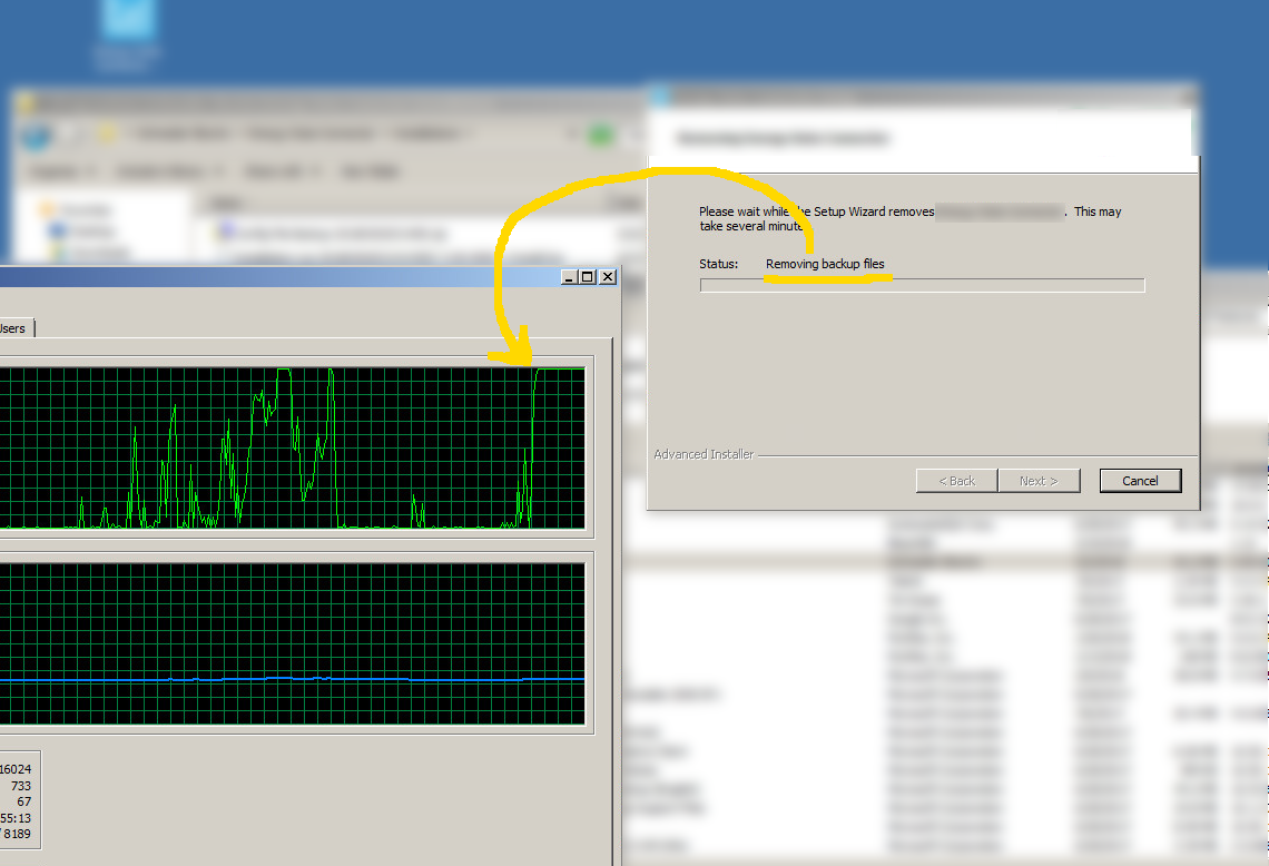

On uninstall on 2008R2 system, two bat files are left consuming 100% CPU. Seems to be happening while the uninstaller UI is displaying the text "Removing backup files". I have repeated this reliably several times on uninstallation.

The problem with the way they behave now is that while they wait, they hammer the user's system at 100% CPU until the resource they are waiting for frees up. Even when that step completes successfully, if you watch the CPU usage it spikes to 100% from the start of the "Removing backup files" stage until the user clicks 'Finish'. To be clear, 100% CPU the whole time so if the user walks away without clicking 'Finish', or if the user kills the installation process at this time, the machine stays at max CPU. This needs to be industrialized a bit.
201803021517 - CPU maxxed during AI busy wait.png (282.38 KiB) Viewed 9725 times
201803021526 - CPU stops maxxing out on Finish button click.png (103.87 KiB) Viewed 9724 times
Here is a solution for AI to modernize that functionality for everyone. The following code is designed such that it is quick if the resource is available, but gracefully extends its time between tries each time the resource comes back unavailable, until it maxes out at a 4 second pulse.
