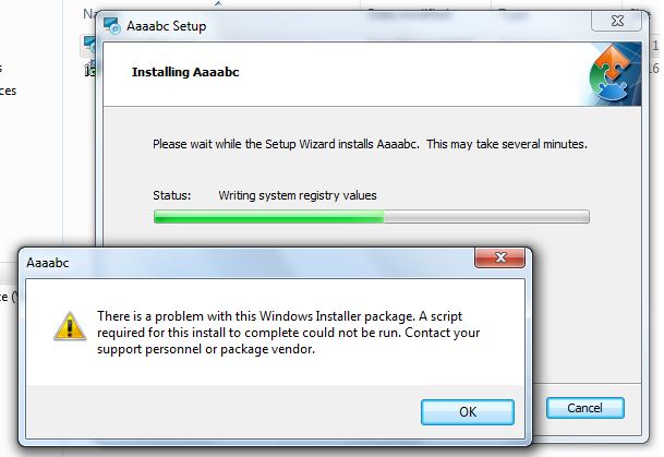

On running the EXE/MSI, i get the below error:
Re: User Input Values while installation
Is there a way to 'Write to a file' with 'Custom Actions' WithOut vbscript ?
Yes, you can write your own custom action which will do that. In example you can build your own DLL which will write text to a file.
Regarding to the related error, please make sure that the VBS custom action is added under "Install Execution Stage -> Add Resources" standard action. Also, the "Property set with Formatted" custom action should be scheduled under "Install Execution Stage -> Add Resources" and before the VBS custom action which writes into the file. If the behavior still persist can you please attach a sample reproducing the behavior?

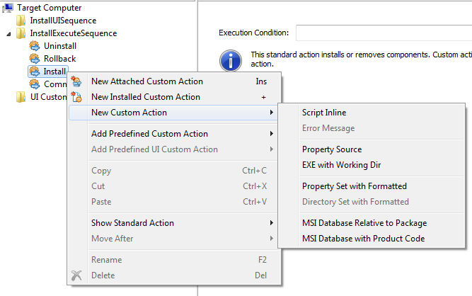

In the Custom Action Page; “Install Execution Stage” is not available in my AI 8.9.
Instead I have “Install execute Sequence”\
And don’t have any “Add Resource” option either. This is a view of my options:
However, I was able to make the EXE work by doin the following :
In my “New attached custom action”, for the ‘Action Data’ property, instead of :
[MY_WS_FILE]|[MY_WS_PROP]
I gave the value of [MY_WS_FILE] directly, as [APPDIR]cvs.txt
So my ‘Action Data’ property read :
[APPDIR]cvs.txt|[MY_WS_PROP]
So, i believe the issue was the PropertySource i was setting : [MY_WS_FILE] ; with the path of the text file was not getting set.
And the EXE installed , and wrote the required edit box value into the cvs.txt file
murug86
Posts: 52
Joined: Mon May 21, 2012 10:59 am
Ok.. My Bad..
As you said, the "Property Set with Formatted" should be placed first. I only got a hang of sequencing now.
The vbScript is working fine for me.
