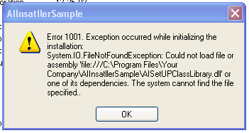

Hi
I have added a .Net Installer class in my project. I have some code to be executed in OnAfterInstall and UnInstall methods.
I have added this as Dll in files and folders. Then added in custom action as .Net Installer class action. with action data as bellow
/LogFile= /ReqVersion=4.0.30319 /InstallType=notransaction /Action=Install "[#AISetUPClassLibrary.dll]" "[TempFolder]NetInstallerClass_Config.xml"
When i build and run, The installation workes well and OnAfterInstall is executed. But when I uninstall I get following error
FileNotFoundException : System could not load file or assembley ....
ScreenHunter_04 Dec. 10 15.11.gif (6.83 KiB) Viewed 3235 times
Please help ...
Re: .Net Installer class in custom actions
This may happens if the related uninstall custom action is launched after its resource files are removed from target machine during uninstall. So, the related custom action should be scheduled before "Install Execution Stage -> Remove Resources" action group.
Let us know if this helped.
