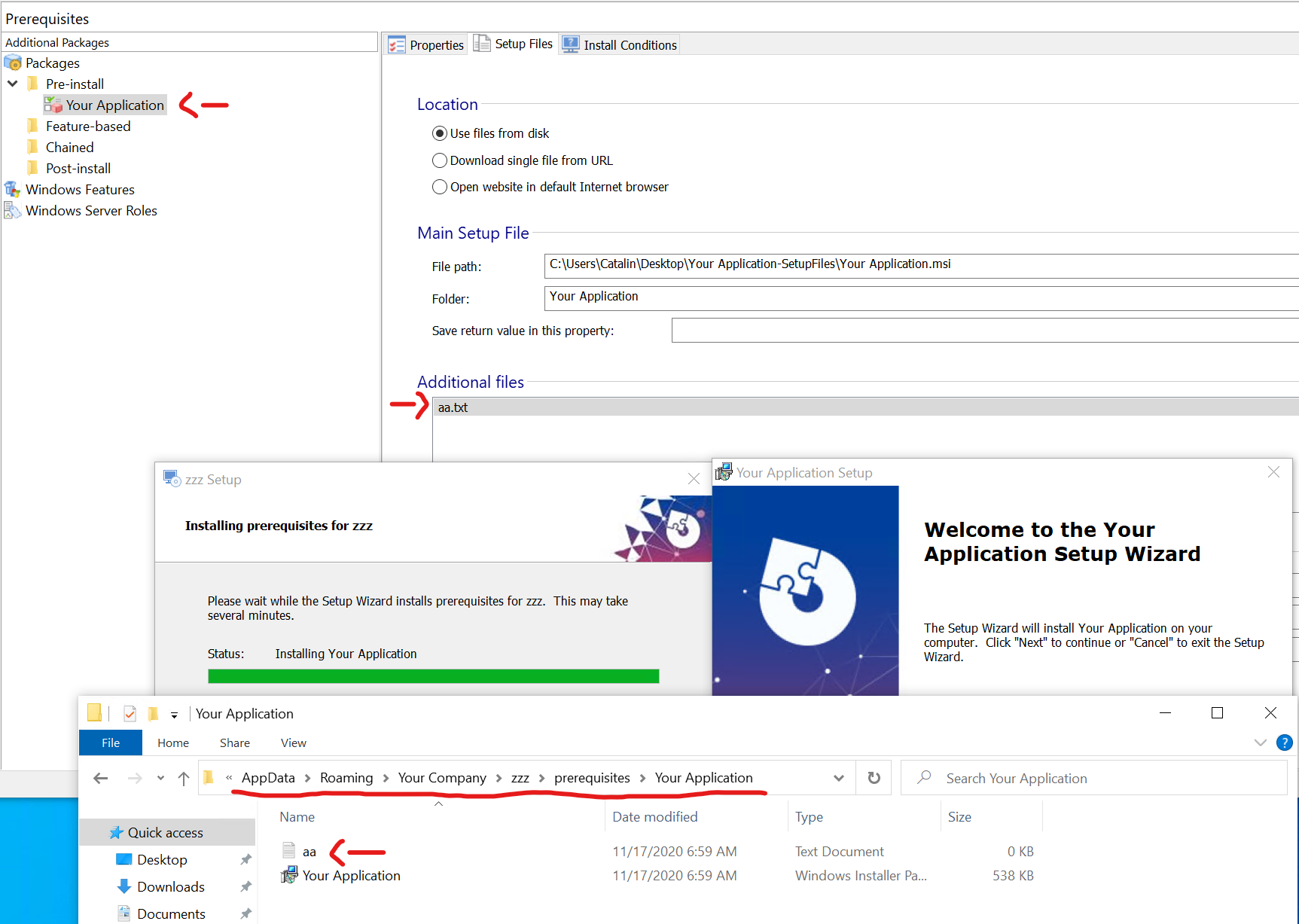

After the installation starts the SQL installer not find the configuration file. We cannot set absolute path for the configuration file like in your example (C:\Users\catalin\Desktop\config.ini) because this will be different in every computer.
If I add the configuration file to the Additional Files, what will be the path, that I can set as a parameter after the setup.exe call (not after the SQLEXPR_x64_ENU.exe call).
The additional file is exctracted in the same place where the prerequisites are extracted. The path can be found in "Prerequisites" page --> click on "Packages" --> "Download/Extraction folder" and its' default path is:
[AppDataFolder][|Manufacturer]\[|ProductName]\prerequisites
