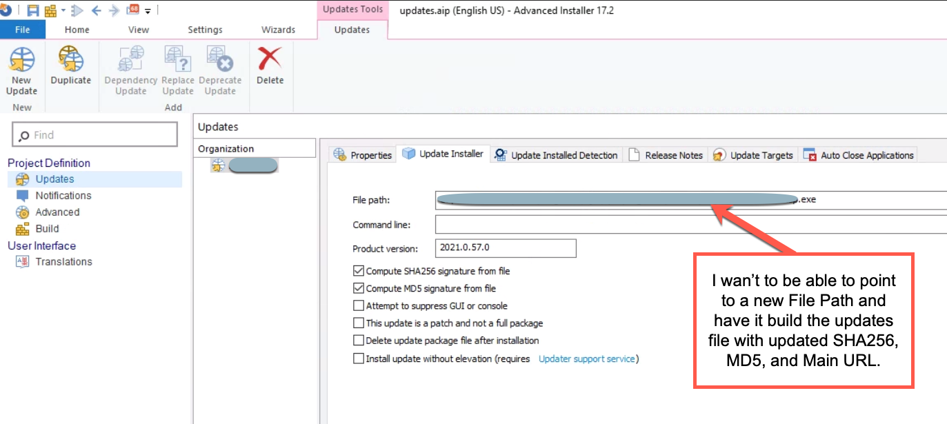

I have an updater and I'd like to automate building a new updates file using powershell with the COM interface. I can't seem to find any commands to do this.
I'd like to point to a new installer exe, have it update the MD5, SHA, version, and also the Main URL for the EXE download. Note that I can't even seem to automate the build process with powershell via COM, as I can with a normal installer build.

I have done some tests on my end and so far it looks like we may not have support to create an "Update Configuration" project.
I wrote to our development team to double check this, but most likely we do not yet support this. If that is indeed the case, I will add this on our TODO list of improvements and hopefully this will be added in a future version of Advanced Installer.
The "PowerShell Automation" support is kind of a recent feature which is not yet fully compatible with our command line support. However, we are constantly improving this over the time, mostly with the help of our users - therefore thank you for bringing this to our attention!
