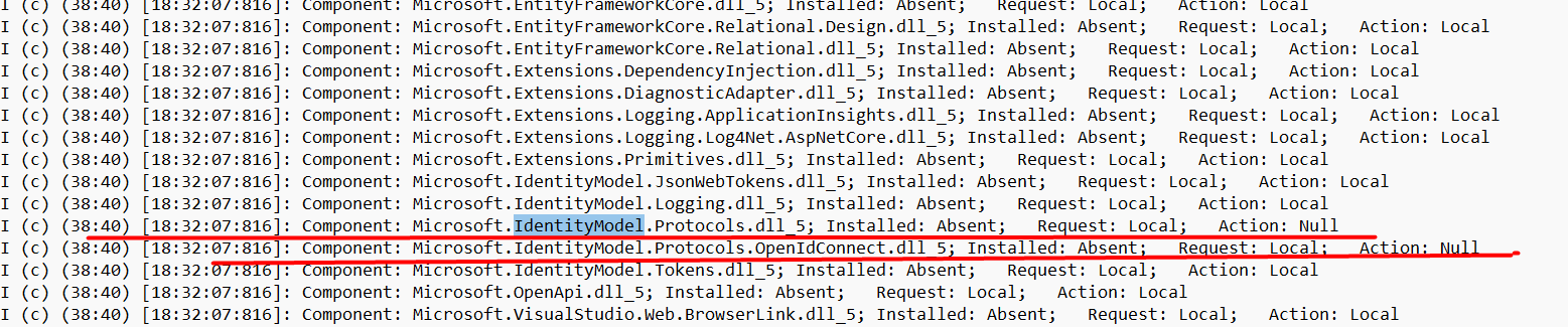

3. I install version 1.0.1 over 1.0.0 and get the error because 2 libraries are missing in product folder: Microsoft.IdentityModel.Protocols and Microsoft.IdentityModel.Protocols.OpenIdConnect.
I looked into install log and found this for them: action: Null.

Short answer, this is not due to the certificate, but rather the versioning of your .DLL files.

Always overwrite existing file option helps.
What a strange coincidence with the certificate.
