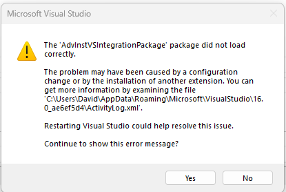

Relatively recently my AI installer project stopped being compatible inside both Visual Studio 2019 and 2022 (I use both for different projects). I cannot work out why. In response I upgraded my AI to the latest version and there are no new versions of VS to upgrade to.
When I start up VS I get the error message:
Screenshot 2024-01-08 165833.png (17.37 KiB) Viewed 40800 times
Here is the relevant section of the activity log
<entry>
<record>636</record>
<time>2024/01/08 17:10:18.955</time>
<type>Error</type>
<source>VisualStudio</source>
<description>CreateInstance failed for package [AdvInstVSIntegrationPackage]Source: &apos;mscorlib&apos; Description: Could not load file or assembly &apos;file:///c:\users\david\appdata\local\microsoft\visualstudio\16.0_ae6ef5d4\extensions\dtiuxamq.af4\AdvInstExtensionVSIntegration.vcs16.dll&apos; or one of its dependencies. The system cannot find the file specified.&#x000D;&#x000A;System.IO.FileNotFoundException: Could not load file or assembly &apos;file:///c:\users\david\appdata\local\microsoft\visualstudio\16.0_ae6ef5d4\extensions\dtiuxamq.af4\AdvInstExtensionVSIntegration.vcs16.dll&apos; or one of its dependencies. The system cannot find the file specified.&#x000D;&#x000A;File name: &apos;file:///c:\users\david\appdata\local\microsoft\visualstudio\16.0_ae6ef5d4\extensions\dtiuxamq.af4\AdvInstExtensionVSIntegration.vcs16.dll&apos;&#x000D;&#x000A; at System.Reflection.RuntimeAssembly._nLoad(AssemblyName fileName, String codeBase, Evidence assemblySecurity, RuntimeAssembly locationHint, StackCrawlMark&amp; stackMark, IntPtr pPrivHostBinder, Boolean throwOnFileNotFound, Boolean forIntrospection, Boolean suppressSecurityChecks)&#x000D;&#x000A; at System.Reflection.RuntimeAssembly.nLoad(AssemblyName fileName, String codeBase, Evidence assemblySecurity, RuntimeAssembly locationHint, StackCrawlMark&amp; stackMark, IntPtr pPrivHostBinder, Boolean throwOnFileNotFound, Boolean forIntrospection, Boolean suppressSecurityChecks)&#x000D;&#x000A; at System.Reflection.RuntimeAssembly.InternalLoadAssemblyName(AssemblyName assemblyRef, Evidence assemblySecurity, RuntimeAssembly reqAssembly, StackCrawlMark&amp; stackMark, IntPtr pPrivHostBinder, Boolean throwOnFileNotFound, Boolean forIntrospection, Boolean suppressSecurityChecks)&#x000D;&#x000A; at System.Reflection.RuntimeAssembly.InternalLoadFrom(String assemblyFile, Evidence securityEvidence, Byte[] hashValue, AssemblyHashAlgorithm hashAlgorithm, Boolean forIntrospection, Boolean suppressSecurityChecks, StackCrawlMark&amp; stackMark)&#x000D;&#x000A; at System.Reflection.Assembly.LoadFrom(String assemblyFile, Evidence securityEvidence)&#x000D;&#x000A; at System.Activator.CreateInstanceFromInternal(String assemblyFile, String typeName, Boolean ignoreCase, BindingFlags bindingAttr, Binder binder, Object[] args, CultureInfo culture, Object[] activationAttributes, Evidence securityInfo)&#x000D;&#x000A; at System.AppDomain.CreateInstanceFrom(String assemblyFile, String typeName)&#x000D;&#x000A;&#x000D;&#x000A;WRN: Assembly binding logging is turned OFF.&#x000D;&#x000A;To enable assembly bind failure logging, set the registry value [HKLM\Software\Microsoft\Fusion!EnableLog] (DWORD) to 1.&#x000D;&#x000A;Note: There is some performance penalty associated with assembly bind failure logging.&#x000D;&#x000A;To turn this feature off, remove the registry value [HKLM\Software\Microsoft\Fusion!EnableLog].&#x000D;&#x000A;</description>
<guid>{634D2762-4905-4843-B74C-649D410524F9}</guid>
<hr>80004005 - E_FAIL</hr>
<errorinfo></errorinfo>
</entry>
I am not sure how to fix this. Any help appreciated.

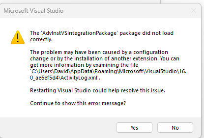

I uninstalled it and planned to go into an VS2019 without a solution open to see if that made a difference. On starting VS2019 I can the same error message coming up:
Screenshot 2024-10-01 142351.png (14.24 KiB) Viewed 24258 times
That would imply that it did not uninstall correctly. When I check in the extensions list it is not present. Is there a way of removing any residual files? Or is it registered somewhere?

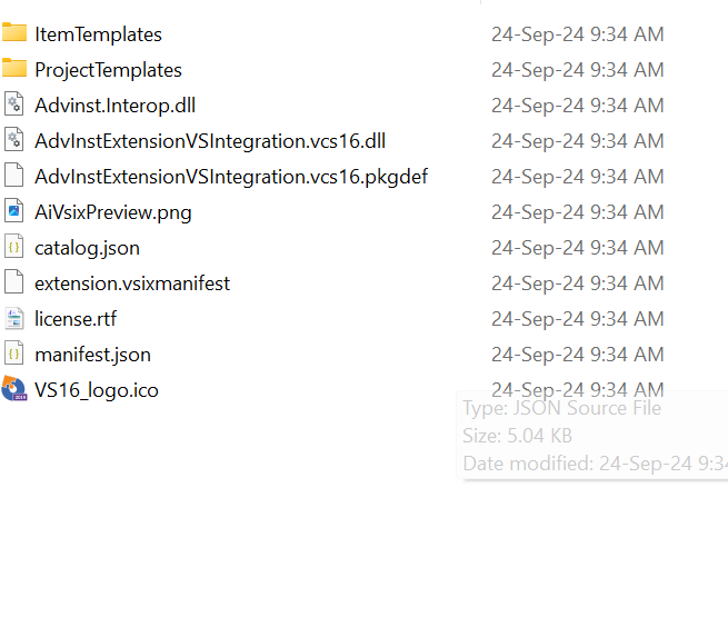

Posts: 1419
Re: Visual Studio 2019 and 2022 extensions incompatible projects
Hello David,
Can you check if you have anything at this location?
c:\users\david\appdata\local\microsoft\visualstudio\16.0_ae6ef5d4\extensions\mxe10vui.fep\
This is what it should look like:
Can you send us a screenshot of the files in this location?
