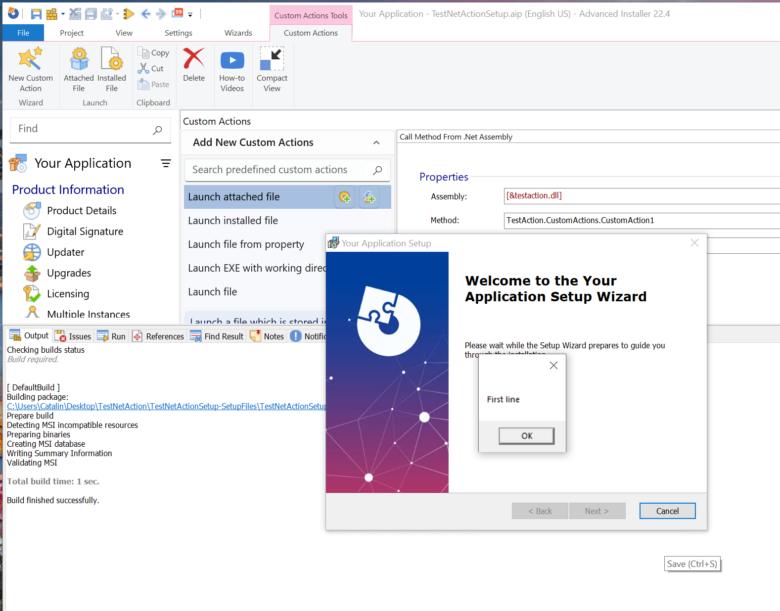

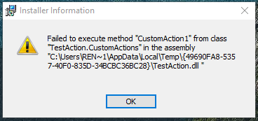

I have created a custom action based on .net Core 8. It runs correctly on my computer.
However, the following error is displayed in my test VM.
However, I cannot find an error here. The .net Core 8 Runtime is installed and other .net Core 8 programmes are executed without errors.
Enclosed is the MSI log file
testactionlog.txt
(72.61 KiB) Downloaded 404 times
of the execution.

Hello Rene,
That error is displayed when something in your code fails during the installation.
As we can see, it is displayed after the messagebox, therefore it fails after.
What I would suggest is trying to debug further your custom action's code to see what the problem is.
If you don't have many lines of code, you can add a messagebox after each line and see where exactly it fails. After that, we can see what the reason might be.

i have used the VS2022 Custom - Action Template from you. I have now extended it to include the output of the MessageBox in the first line.
Unfortunately without success.
I have attached my setup and CustomAction project here.

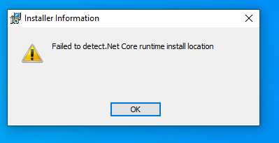

On my VM, I had a really strange error "Failed to start .NET" - so not really the same as yours. This ended up happening because I did not have the DLL file on my VM and I was building the project using dummy resources.
After fixing that, everything worked just fine on that VM as well as on my own machine.

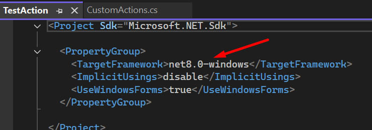

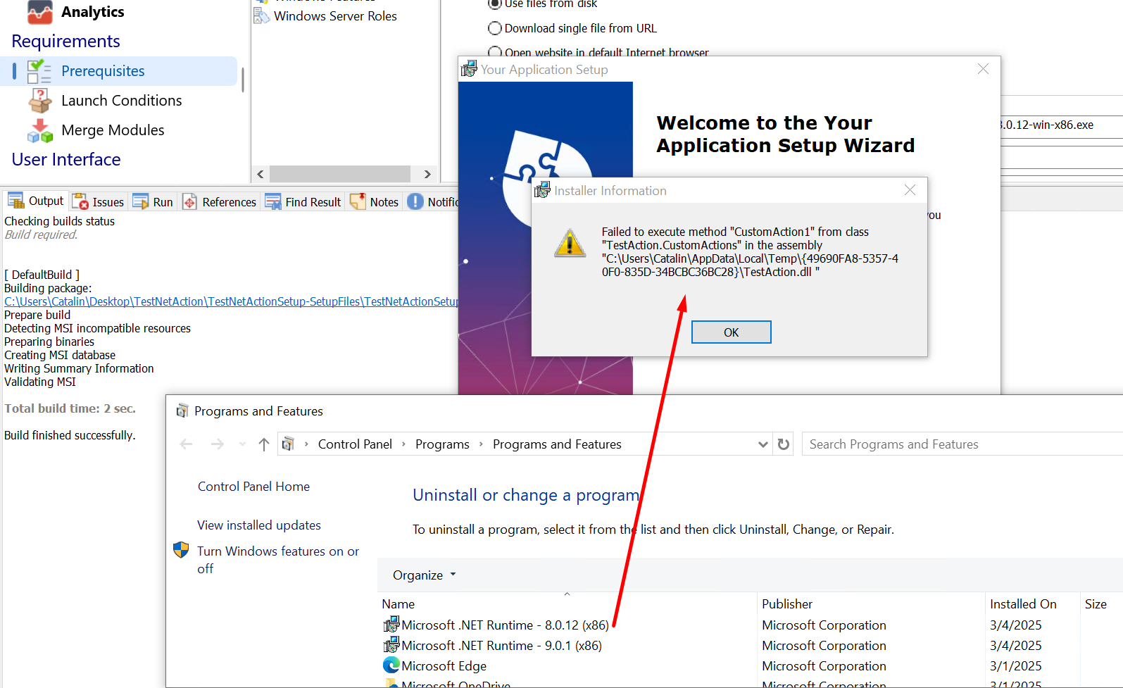

After further playing with this, I think the issue actually is the fact that you do not have the WindowsForms support on your end.
On my end, when I had only the runtime installed, I managed to reproduce the same issue:
Please note that in order to have the WinForms support, you need to .NET Desktop Runtime and, of course, a version matching yours from the project, aka 8.x:
Here is a download link:
https://dotnet.microsoft.com/en-us/download/dotnet/8.0

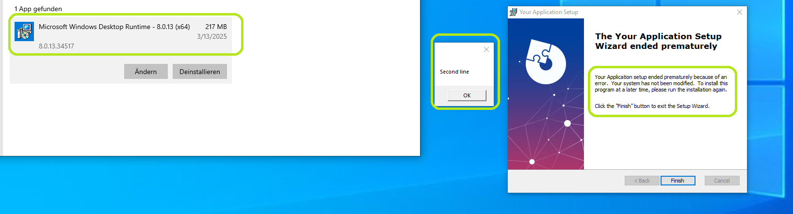

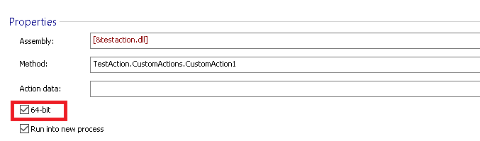

Thank you for your test. I have probably found the cause. But I think something is still not quite right. My software is based on .net core 8 (x64). I have therefore only installed the 64-bit version of the desktop runtime as prerequisites. My custom action DLL is compiled as ‘Any CPU’ and should therefore run under x86/x64. However, it seems that the custom action explicitly runs as x86. However, since only the x64 desktop runtime is installed, this error occurs with the current AI version.
That's ok for now. If I install the .net core 8 (x86) version, the custom action runs as desired.
I have therefore now activated this check box in the custom action as I don't really want to install the x86 runtime if I don't need it myself.
The custom action is now started.

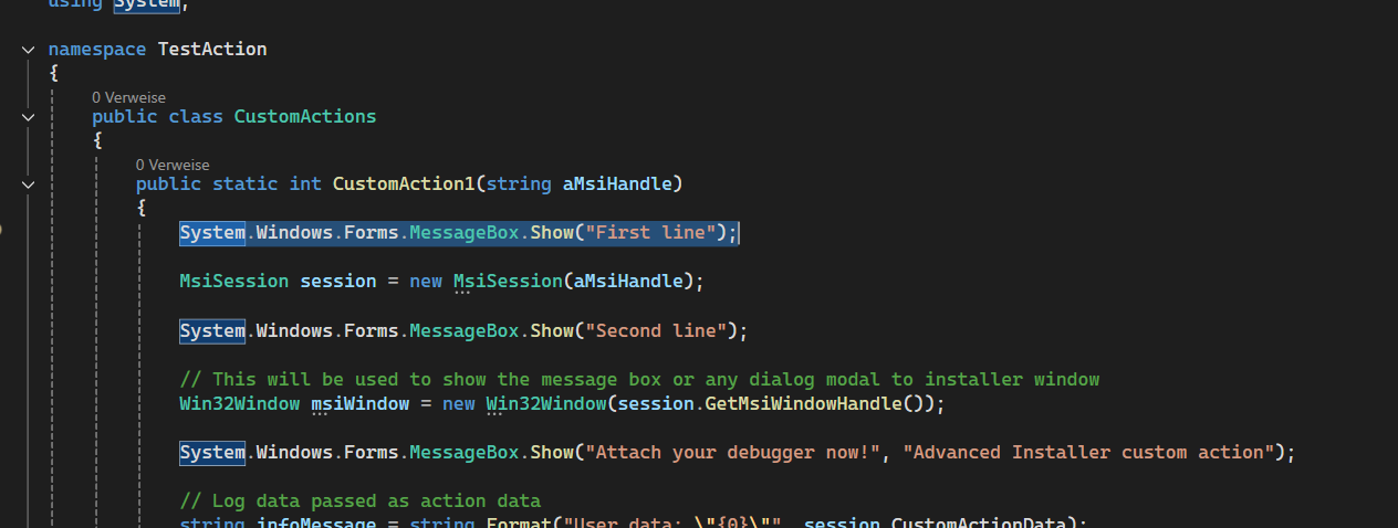

However, the setup is cancelled at the following line. The next MessageBox is not displayed.
System.Windows.Forms.MessageBox.Show("Second line");
// the custom action is cancelled here

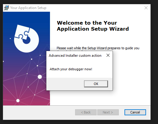

Win32Window msiWindow = new Win32Window(session.GetMsiWindowHandle());
System.Windows.Forms.MessageBox.Show("Attach your debugger now!", "Advanced Installer custom action");

It looks like this has been a bug on our side, indeed.
I will email you a file that you can just replace and this should be fixed.
After testing, please confirm that everything is working as expected.

the CustomAction is now working as desired under the x64 - .NET Core Runtime. Thank you very much for your efforts.
