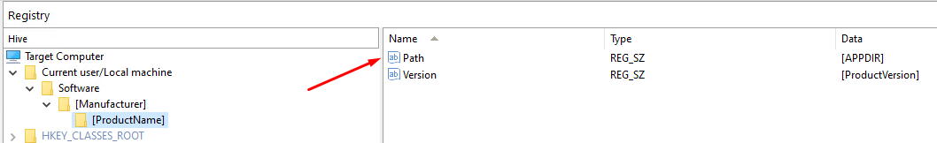

We don't quite need to complicate ourselves here, as the installation path is already written by default in the registries.
During an upgrade, however, we have to note that this will be removed together with the previous package, so if we want to read it, we should do so before that happens.

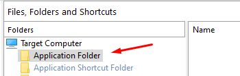

Additionally, this only works if we have used the predefined "Application Folder" from Advanced Installer:
since APPDIR is a property that stores the value of that folder.
