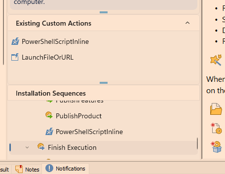

add exclusion to windows defender for app dir, cant get it to work
Hi, i'm trying to do a powershell script in my installer that add the installed directory to the list of exclustions in defender.
I've seen a couple posts on here but I can't make any of it work.
please see the attached image for my script. I'm sure i'm missing something simple but I can't find it.
I tried both deferred execution as well as commit. neither worked so far.
it's sequenced after PublishProduct in my list
TY
Re: add exclusion to windows defender for app dir, cant get it to work
The first mistake I can see is a typo in the variable name.
-appdr should be -appdir
If that still does not work, then another issue could be the admin rights.
You can check whether the script works without admin rights by launching a PowerShell and trying to add a random folder to the exclusion list. Preferably, the folder should be from the C:\Program Files so it matches what you try to achieve in the installation package.
jspano
Posts: 3
Joined: Mon Jul 01, 2024 3:27 pm
Ah crap, sorry TY, i totally missed that.
works now.
Do you know what will happen if it's not ran as an admin though? If it fails for that i don't care.
i have it set to not fail if the custom actoni returns an error.
is that enough?
You are always welcome, glad to hear it works as expected now!
Regarding your new question, if you unchecked the option to end the setup if the custom action fails, then yes, it should be enough to not end the entire setup.
Normally, if a custom action fails, the entire setup will fail and rollback all the changes it made.
