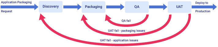

End-to-end Packaging Process
Now that we understand how that end-to-end packaging is helpful but is not necessarily the answer to all of our problems, let's go through the end-to-end packaging process. Now, in most organizations, the end-to-end packaging process consists of 3 main steps:
  • 1. Application Discovery
  • 2. Application Packaging
  • 3. UAT (User Acceptance Testing)
Organizations that care about the quality of their packages have also introduced an extra step: the review of the packages created by a senior packager (QA).
From a high-level perspective, the process must look like the one in the diagram below.
App packaging process

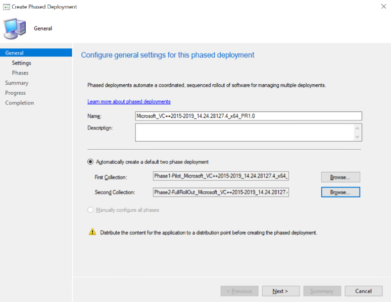

4. Phased and controlled rollout.
Although the package was tested and UAT was signed off, there is always a risk for something to go wrong when rolling it out to production devices.
Companies should not take any risk. If they take it - it should be mitigated as much as possible, so a regression plan must be in place in case something goes wrong. Therefore, from a deployment perspective, a phased and controlled deployment approach is something to take into consideration. This can be achieved by manually adding members to the collections, or using the Phased Deployment feature included in the Configuration Manager.
Phase deployment configuration manager
Phased Deployment in Configuration Manager Console
