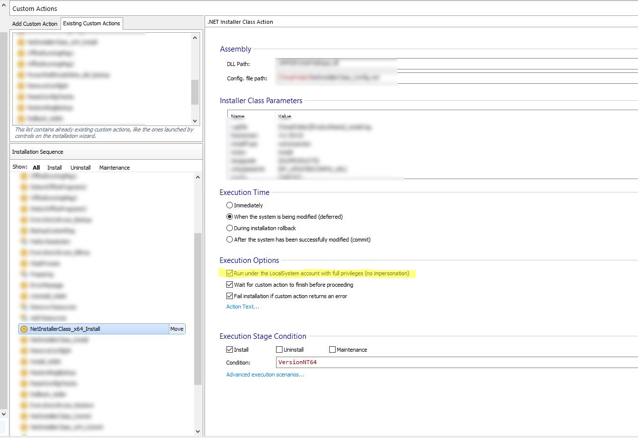

The custom action that fails may need administrative privileges so in this case you should have the "Run under the LocalSystem account with full privileges (no impersonation)" option enabled from the "Execution Options" section.
Can you try the above option and tell us if this helps?

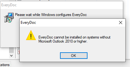

So if the target machine does not have the ".NET Framework 4.6.2", then the launch condition will be triggered thus the installation will fail. The launch condition prevents the setup from being installed on a machine where the requirements are not fulfilled.
For example, if I try to install your setup on a machine without Outlook 2010, the install fails with the following error:
