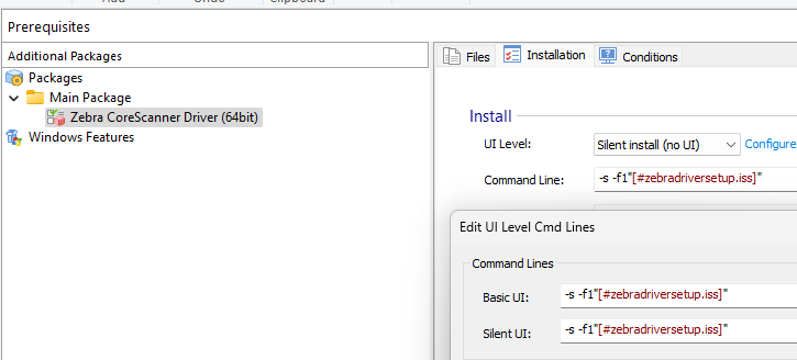

I'm trying to install a driver package in silent mode and per their documentation, this is the command needed:
"Zebra CoreScanner Driver (64bit)" -s -f1"zebradriversetup.iss"
When I run this from C:\Windows\systems32.cmd.exe it works just fine. When I tried to build an MSI with it in the prerequisite section, it does not work. I think I've finally figured out that it is launching PowerShell instead. Trying the above command in PS does not work manually.
So how do I fix this?

If I create a batch file with this line, this works when I just run the batch file manually.
Zebra_CoreScanner_Driver -s -f1"c:\kak\zebradriversetup.iss"
I'm not sure why this doesn't work in the PreReq section.

Re: Install prerequisite from command prompt, not Powershell
I just tried copying the exe and associated files to a known folder, then running a batch file and it does not work.
Command prompt opens, it appears to be installing but it doesn't.
Turns out the Driver package behavior is inconsistent with the silent switch. I ended up using the SDK package and it works is the PreReq section.
Maybe this will help someone in the future.
