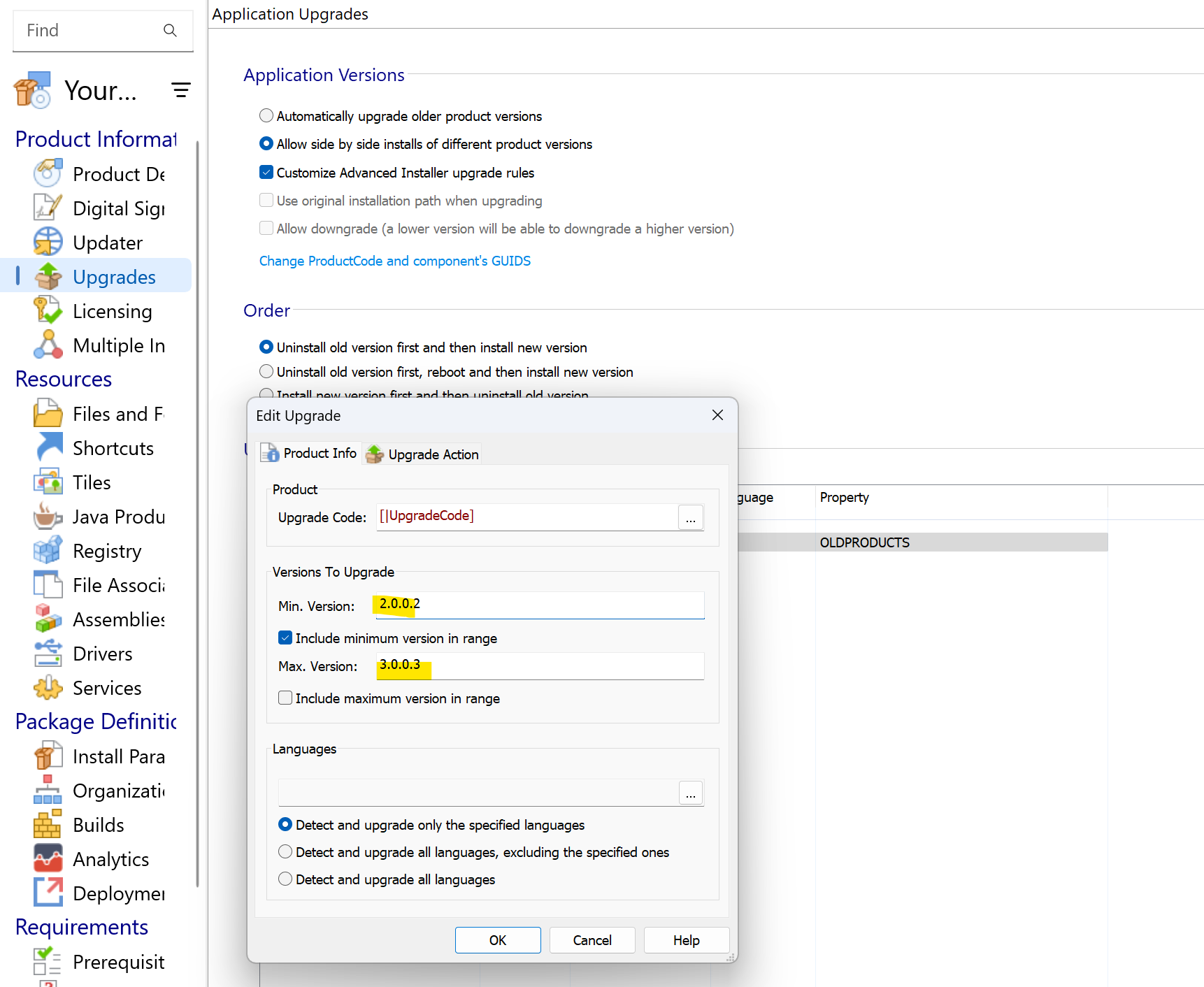

I found an article on a website that explains how users can choose between installing a new version of software side-by-side with the old version or removing the old version to install the new one using UpgradeDlg.
https://www.advancedinstaller.com/user- ... dedlg.html
The article mentions an option to remove all old versions. Is there a way to selectively remove only specific old versions instead?
Kevin
Re: Could not uninstall package with Powershell
Hi Kevin,
You can try to control the specific versions you want to selectively remove from "Upgrades" page.
Just go to "Upgrades" page and check the "Customize Advanced Installer upgrade rules" option. Then double click on the OLDPRODUCTS row under "Upgrades" section and configure the "Versions To Upgrade" fields.
Here you can define a range of Product Versions you want to be upgraded in case "Yes, remove old versions" option is selected on "UpgradesDlg" dialog.
However, this range of versions can be defined and set only when building your setup project, at build time. If you want to be able control this range of versions at install time (when your setup is run) I am afraid this is not possible.
