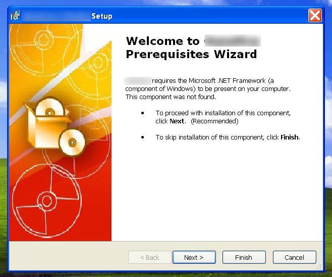

I just wanted to add that I noticed that the prerequisites wizard scales the images along with the dialog. This makes the images look weird and pixelated, but it's probably better than scaling the dialog without scaling the images. My preference would be for nothing to be scaled.

Please note that in the Theme tab of the "Global Properties" dialog you can select the "Stretch with fonts" option. This will make Windows Installer stretch the images to match the large fonts.

I should have guessed that the solution was already there. :oops:
As always, thank you Cosmin. :D
