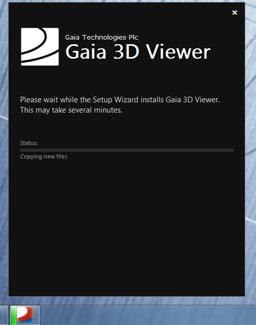

I have just created a new installer using the new surface theme.
The installer will install the product successfully, but when it is on the progress dialogue of the copying files stage the bar goes up a tiny bit, then back to 0% then 1%.
It repeats this process all the way through, but interestingly, the progress bar on the windows tool bar at the bottom is working correctly.
Using Windows 7 x64
When I un-install the software, the progress bar works correctly.

I'm afraid this is a normal Windows Installer behavior. We may improve this behavior in a future version of Advanced Installer, thank you for bringing it to our attention.

I've increased the priority for this issue, but I'm afraid that we cannot give you an ETA for now. Thank you for your understanding. However, until then, as a workaround, you can proceed like this:
- Go to Dialogs page and select the "ProgressDlg" dialog from "First Time Install" tree node.
- Select the progress bar control and edit its subscribed event like this:
  • Subscribe To: Display overall installation progress (enhanced UI only)
    Attribute to set: Progress
- Build and run your project.
Let us know if this helped.

the problem also happens if you use Styled Progress in surface theme ProgressDlg,
but another workaround I found is to use simple progressbar instead of Surface progess or Styled progress.
anyway we still wait for a fix :-)
