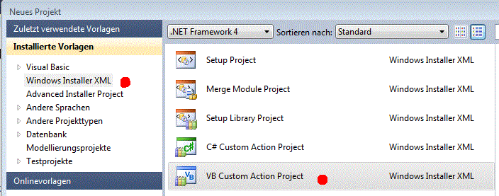

The VB project you have generates an EXE file and shows a form, this is not the same project type outlined by Eusebiu in the screenshot.
Please install Wix Toolset and create exactly that project type, this should have as output and DLL file, not an EXE.

I downloaded as well and made a gif. As you can see there is a folder "Adv_CustomAction1" inside the project, which make those DLL.
That rar file has that exe, just to completed to make it easyer for you.

the gif shows what I've choosen, its the same as eusebiu shows on his gif.
Made that DLL in that way.

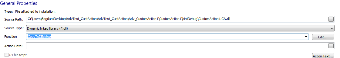

As explained in our tutorial this type of custom action creates two DLL files, the one you need to use is the one with the name ending with ".CA", as you can see in the attached picture, under "Source Path" field.
Also, in the "Function" field you need to specify the name of your custom action from the DLL that should be called. You can have multiple custom actions in a DLL so the MSI requires for your specify it.
Even if there is a single custom action in it you still need to specify the function name.
Please analyze carefully our tutorial if you will also need to debug your custom action.

My first attachmant, seeable here, third step.
C:...AdvTestDLL\BeforInstallCopy.dll
It has ".DLL" instaed of "CA.DLL".
First notice about "Uninstall" and "Maintenance" has came with third answer of eusebiu.
(Sat Apr 13, 2013 1:43 am ) again an attachment with DLL instead of CA.DLL
(Sat Apr 20, 2013 7:37 pm ) dito
(Wed Apr 24, 2013 6:43 pm ) I had to make you sure guys, that it has CA.DLL, AND that I havnt use an exe instead of DLL(have to read it more times than one to belive it)
