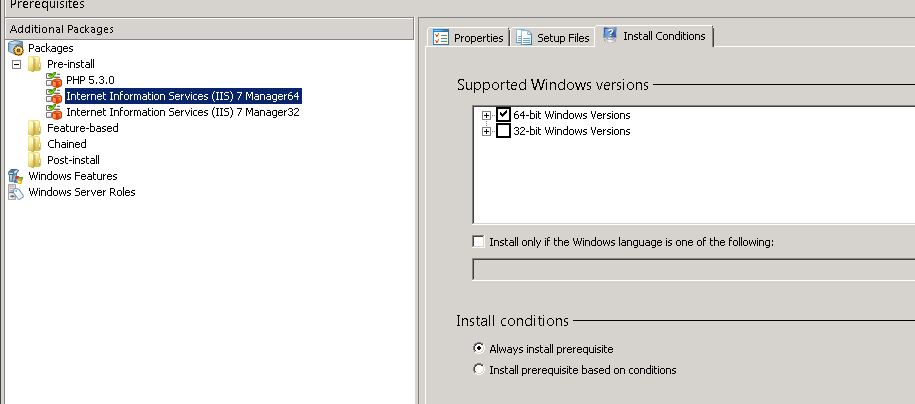

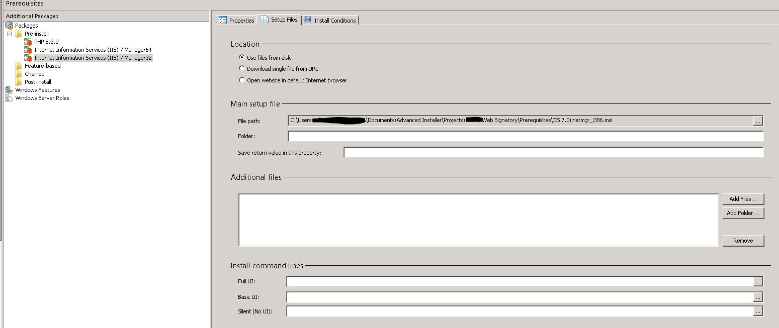

I am doing exactly what you have suggested for 32bit and 64bit version but it produces an error during the installation that the file cannot be found so not sure what to do? I believe the path for Source from disk is local path and installation is trying to find that path but could not find it. I would like to suggest you to have a path which is within the same installer so can get the installation source.
Please see the attached images for your reference.
Thanks for your assistance!
Upendra
Prerequisite installer path
Installer path.JPG (95.01 KiB) Viewed 4527 times
Condition for 64bit
Condition for 64bit
Condition for 32bit
Condition for 32bit
