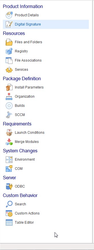

But i import an existing MSI and on the left pane i don't have Dialogs, how can i do a loop with just Custom Actions ?

Posts: 4971
Re: Loop for Detect Process
In order to add the "Dialogs" page in your project you can use the "Add/Remove" link from the bottom of that pane and select the page in the full list.
I'm afraid that if you want to achieve this from the "Custom Actions" page you need create your own custom action that check if the process is running and displays a message box until the users closes the process.

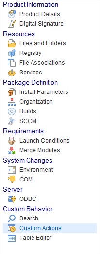

But when i import an existing MSI (not created with advanced installer) i don't have the "add/remove" button, and when i create a new project i have this button
There is a option for activate the dialog pane ?

Posts: 4971
Indeed, that option is not available when you "Edit an MSI in Advanced Installer", but if you use the import it using the "Import MSI" feature the "Add/Remove" option and the "Dialogs" page will be available, too. However, in this case a new MSI package will be created, it will not modify the existing one.
I'm afraid that if you want to edit the existing MSI you will need to create your own custom action as I explained in a previous post.
