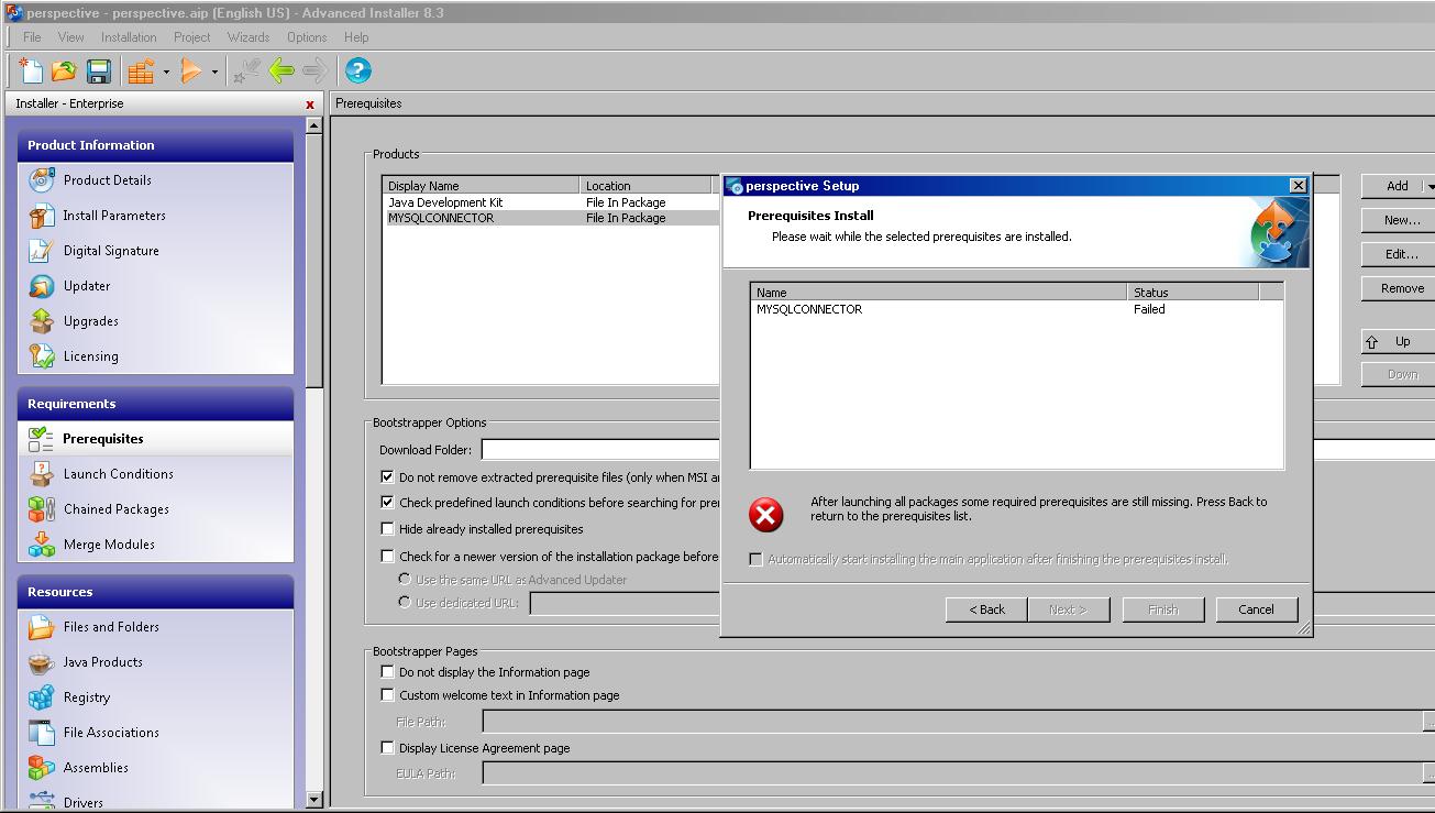

I have a issue in adding perspective to my installer. I want java,MYSQL Connector perspectives to my installer. Before installing main application, it need to check whether the perspectives are installed or not. If not installed it need to be installed.
So what i have done so far is, I added java perspective from perspective page-->product tab-->add-->java-->JDK-->File path with global perspective. and For MYSQL connector-->New-->adding MYSQL connector file location with global perspective type.
Now issues is When I install MYSQL connector after installing MySQL Connector I am getting status as failed and it is asking me to click on back button. Even MY installation went successful it still getting status failed. I goggled and tried with many settings

Please check the above screen shot and aip.
Its really very very urgent to solve this issue. waiting for the reply

Re: Prerequisites Install dialog shows "Failed"
As I said in previous post, this may happens if you are not using valid install conditions for the related prerequisite package (MYSQLCONNECTOR). Can you remove, from "Prerequisites -> Install Conditions" tab, the following search
  • Criteria: Product Version (identify by Product Code)
    Product Code: {00000000-0000-0000-0000-000000000000}
and see if the behavior still persist?

Hi Daniel,
Still I am getting "Status: Failed" after successfully installing MYSQL ODBC Software. IT need to get "Status:Success" and open the main installation automatically.
Please tell me what configurations I need to change to make the Status: failed to Status:success". Its really emergency. Please let me know as early as possible.
Please check my attached aip file
perspective.aip
(10.72 KiB) Downloaded 591 times
Can you replace your prerequisite install condition with the following condition:
  • Criteria: Registry value containing a version
    Registry Value: HKLM\SOFTWARE\MySQL AB\MySQL Connector/ODBC 5.1\Version
    Minimum: 5.1.10
