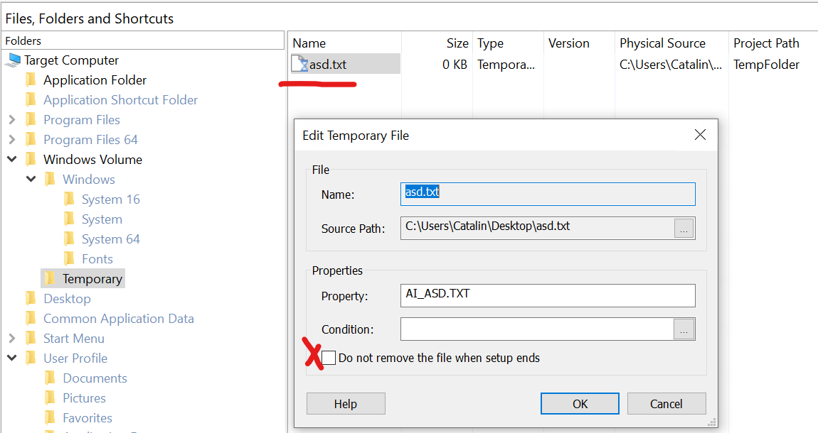

Re: Running batch files having sub-batch files
Hello Aswin,
First of all, thank you for your kind words.
In addition to what my colleague Liviu said, please note that, if you have added your files as "Temporary Files", you can select to not remove them when the installation ends.
To do so, please go to "Files and Folders" page --> double click on your temporary file --> check the "Do not remove when installation ends" option.
I will attach below a screenshot for your reference:
As you can see in my screenshot, Temporary Files have a special icon (unlike regular files).
