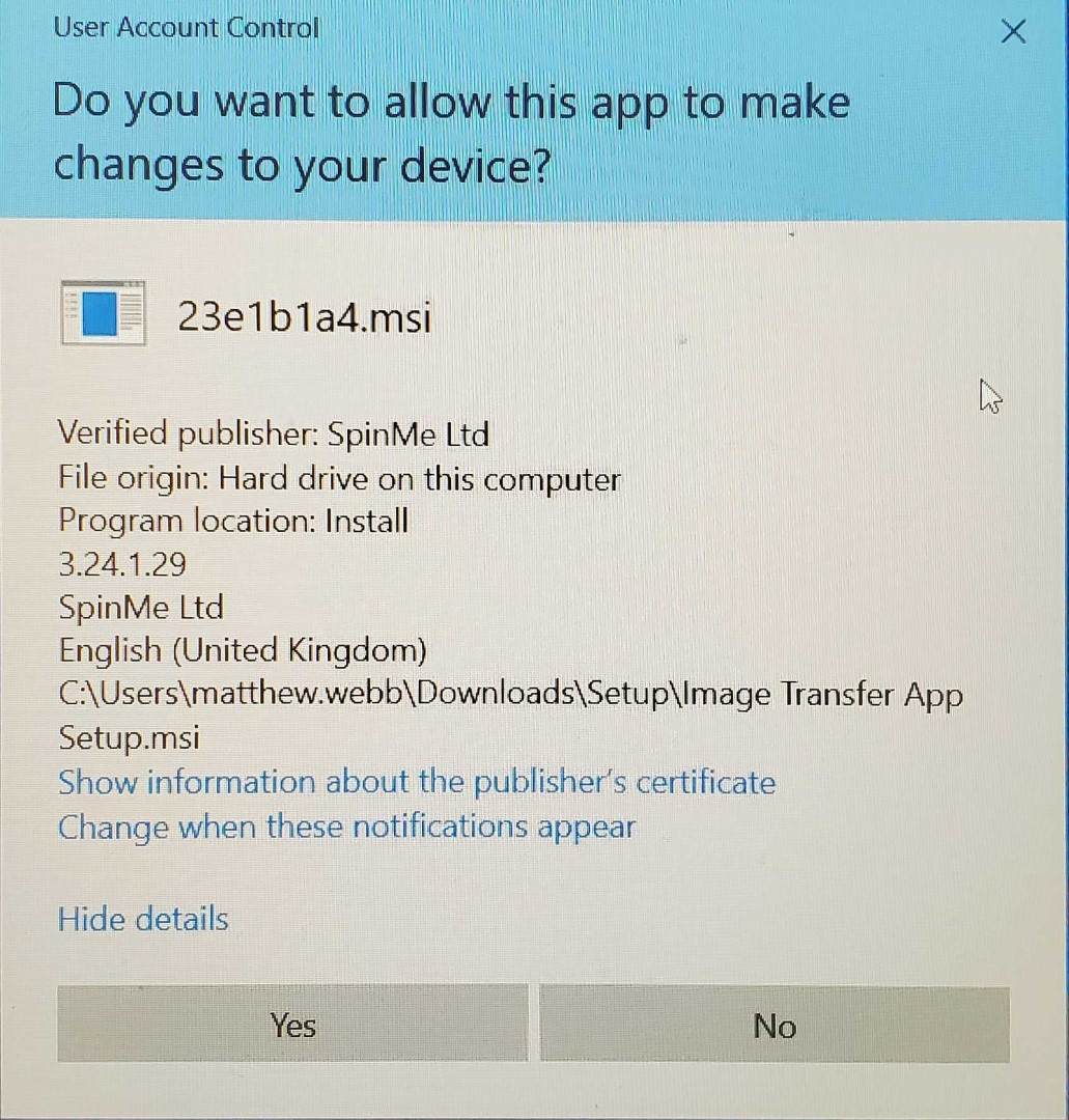

We are using Advanced Installer to create an msi file. We use Trusted Signing to sign the msi and that is all working fine. The dialogs that come up as part of the standard install process show our company name and details as set up in the aip configuration file. However when the UAC prompt appears asking the user to confirm that changes can be made to their computer, the msi name in the dialog is a random set of characters (see attached image). Having read some other posts, it seems to be that the Description in the SIgnature part of the aip configuraiton needs setting, but we do this and still get a random file name. Is there anything else I'm missing?

The information displayed on the security dialog (UAC prompt) is collected from the digital signature of the package. In this particular case if you set the Description field from the Digital Signature page it will display the correct package name.

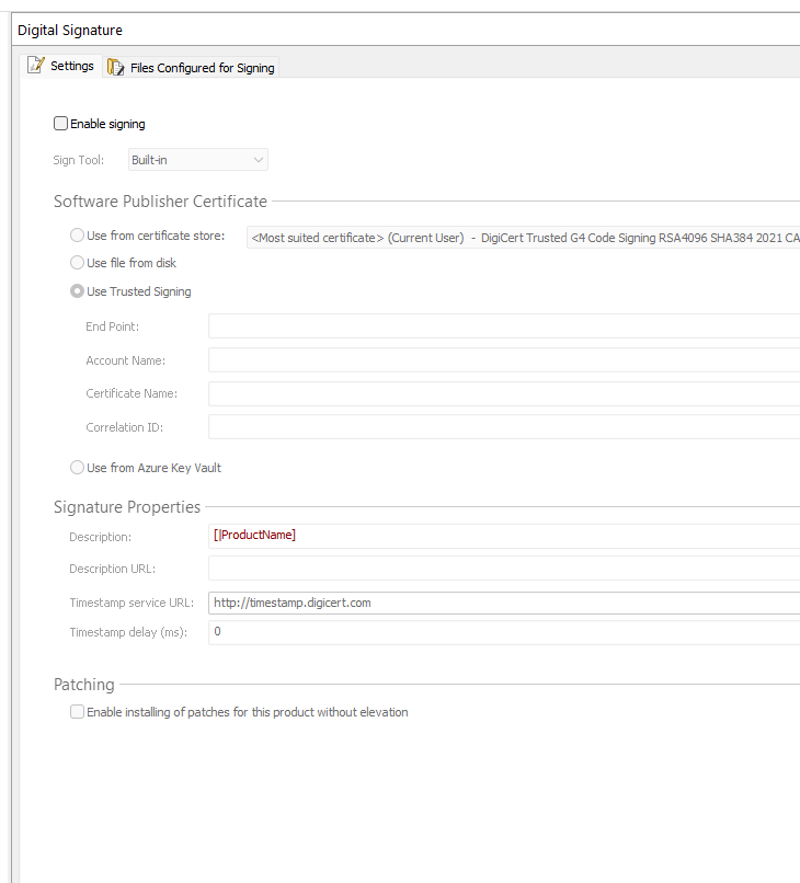

Re: UAC Prompt shows incorrect msi name
thanks for your response.
Not really, it is grayed out because I cannot enable the signing (the project will not compile anymore).
Nevertheless, the description with the product name is set as shown in the attached screenshot. However, this is not used in the UAC dialog...
Hello Tobias,
Could you please give me some more details on this?
The fact that it is grayed out means the option is not enabled, as we can see in the screenshot. Of course, if the option is grayed out, the "Description" field that you completed will not be taken into consideration.
Do you encounter any errors during the build? If so, did you manage to find why that is? Is it because of this?
Trust Manager is not supported there.
Perhaps you can contact DigiCert support team to see if they can assist with this? By default, for signing, we use "signtool" which is the default tool in Windows. However, if they have a custom tool, you can also use that as we have the option to use a "Custom SignTool":
I managed the issue by following this thread:
viewtopic.php?t=51686
I added a parameter for the description (/d 'MyDescription') and now the signing works and the UAC dialog shows the right name.
