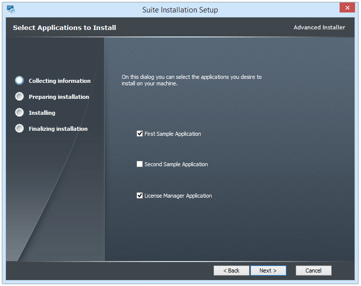

Since your suite installation will install three different applications, you might want to let the user select which application to install. This is an optional step and you may skip if you want your users to always install all available applications.
In this step, we will show you how to create a new installer dialog with custom controls on it. For this scenario, we’re using simple checkboxes from where the suite installer will decide which application to install.

Resulted Suite Installation Dialog - Each checkbox has a property attached to it, visible in the right side pane from Advanced Installer when you select the checkbox control. This property must be set in the Organization page as an install condition for the corresponding feature.

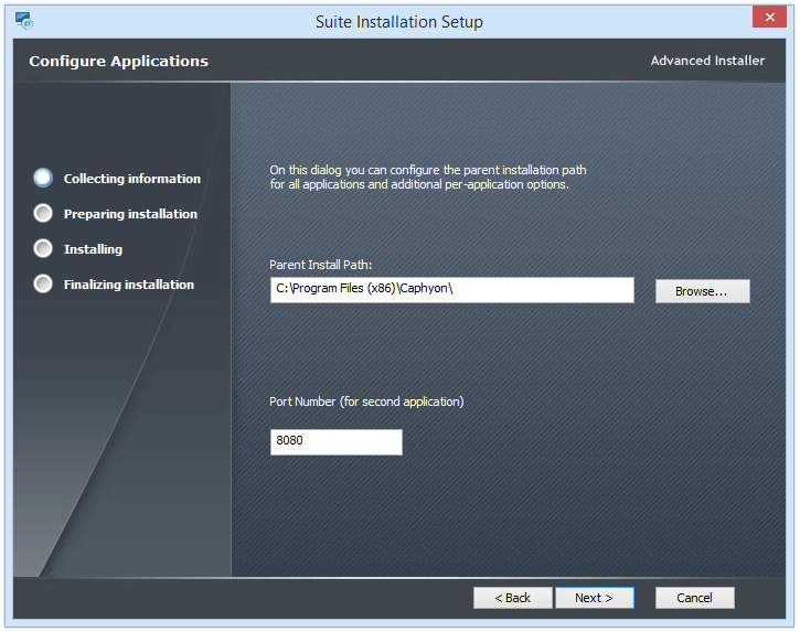

In the image below, there is an example of capturing the parent install path for all applications. We say it is the parent install path, because at the end of this path, we instruct the application to create their own subfolder, by adding this folder in the command line set.
For example, for the second application, we create the subfolder “SecondFolderApp“ (as you can see in the screenshot from step 3).
Also, we capture the port number for the second application and pass that through the command line too. As seen in the image, all the parameters required by the actual installers are passed in their command lines. There is no other way to pass information from the suite installation to the independent installer packages.
