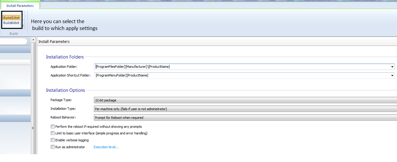

In order to achieve that, you can create in Builds page two builds (one for 32 bit and another one for the 64 bit). Then, you can go in the Install Parameters page and set the Package type for each build. Please note that you can select the build for whom to apply the related changes as you can see in the below image. Also you can take a look Package type article which may be useful to you.
