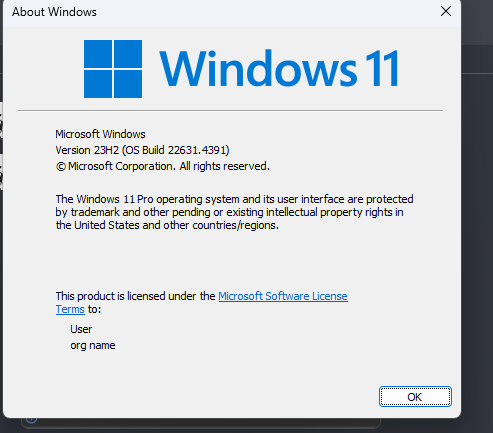

What we observed was that indeed, the presence of PowerToys on the system did cause the issue, however, this does not apply to all OS versions. Specifically, the error appeared on Windows 11 with the 23h2 build:
Windows 11 23H2 version

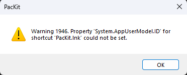

If you’re running Windows 11 23h2 with PowerToys installed, you might encounter this warning during an MSI installation:
Warning 1946 MSI error message

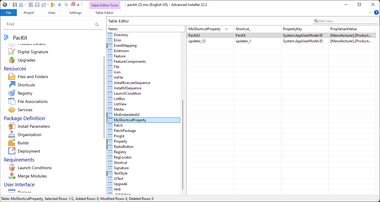

  3. If you are a software packager or an ISV, you can access the MsiShortcutProperty table in the MSI and remove the problematic entries to eliminate the warning.
MSISchortcutProperty in Advanced Installer
