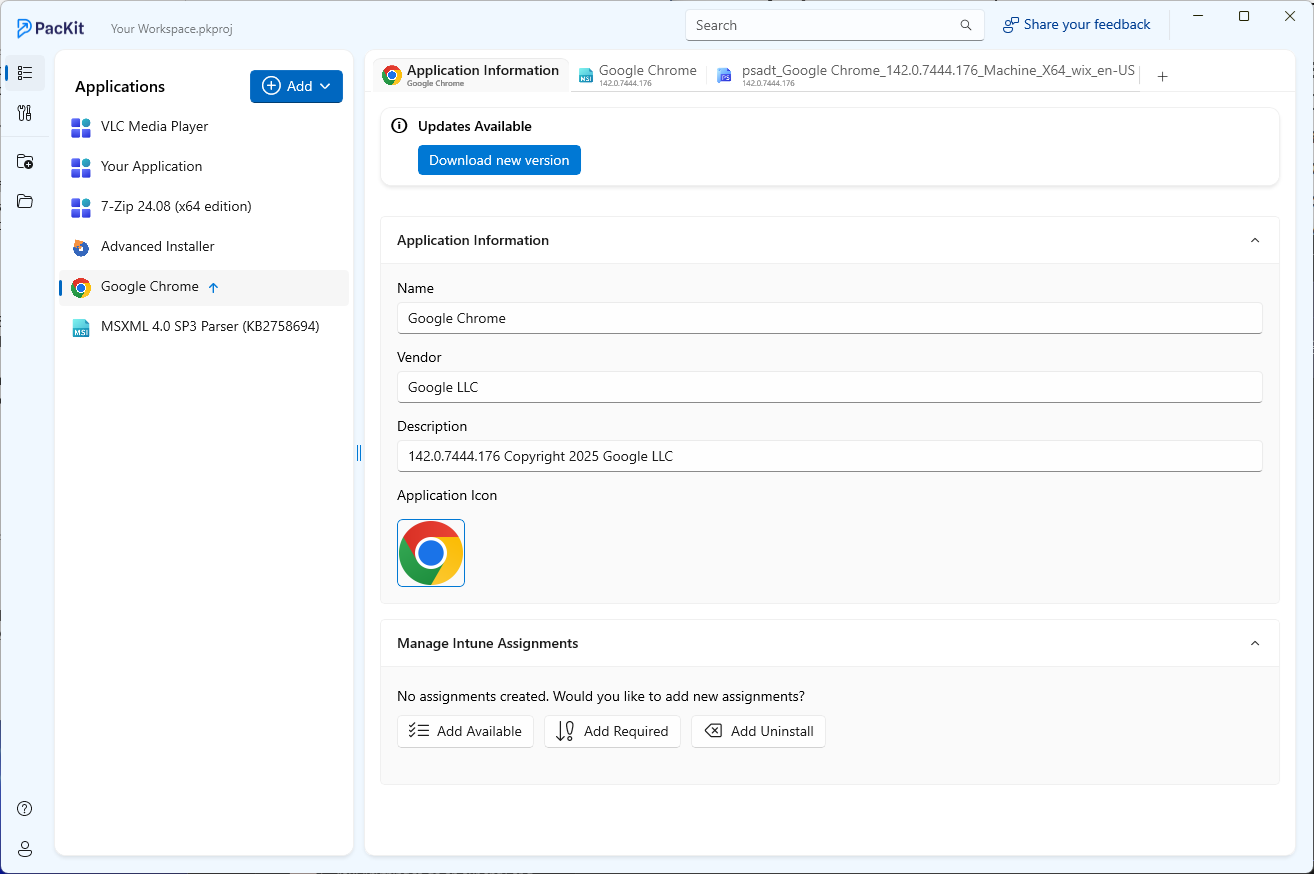

  • To avoid these kinds of issues, organizations use their own software management tools and software packagers. Tools like Advanced Installer or PacKit are excellent tools for software packaging and deployment, and I highly recommend them if you are not familiar with enterprise management solutions.
PacKit graphic interface
