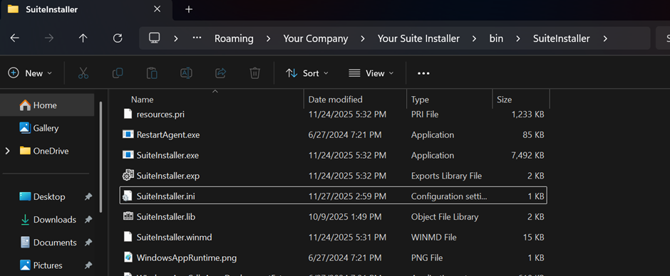

  3. After creating and installing the project, locate the SuiteInstaller.ini configuration file in the following folder:
C:\Users\<UserName>\AppData\Roaming\Your Company\Your Suite Installer\bin\SuiteInstaller
We’ll use it later in the theme project.
Suite Installer folder

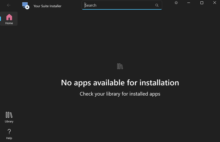

After adding the configuration file, launch the theme project in Visual Studio.
You should now see the Suite Installer theme running and ready for customization.
Suite installer theme running

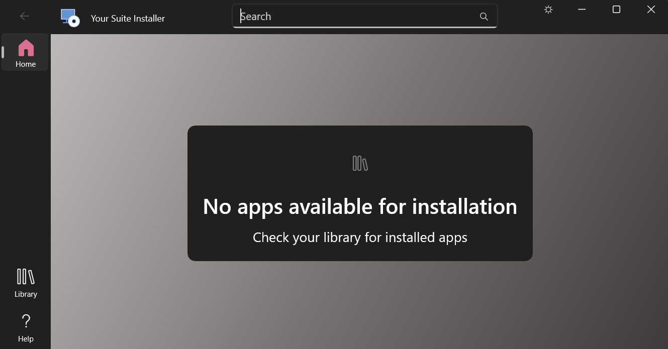

For example, to change the Home page color, simply update the XAML file. Then rebuild and run the project.
For demonstration purposes, we’ve added the code below to the XAML file:
<Page.Background>
    <LinearGradientBrush StartPoint="0,0" EndPoint="1,1">
      <GradientStop Offset="0" Color="{ThemeResource SystemAccentColorLight2}" />
      <GradientStop Offset="0.5" Color="{ThemeResource SystemAccentColor}" />
      <GradientStop Offset="1" Color="{ThemeResource SystemAccentColorDark2}" />
    </LinearGradientBrush>
</Page.Background>
Here’s how our theme looks after changing the Home page color:
suite installer theme background color change

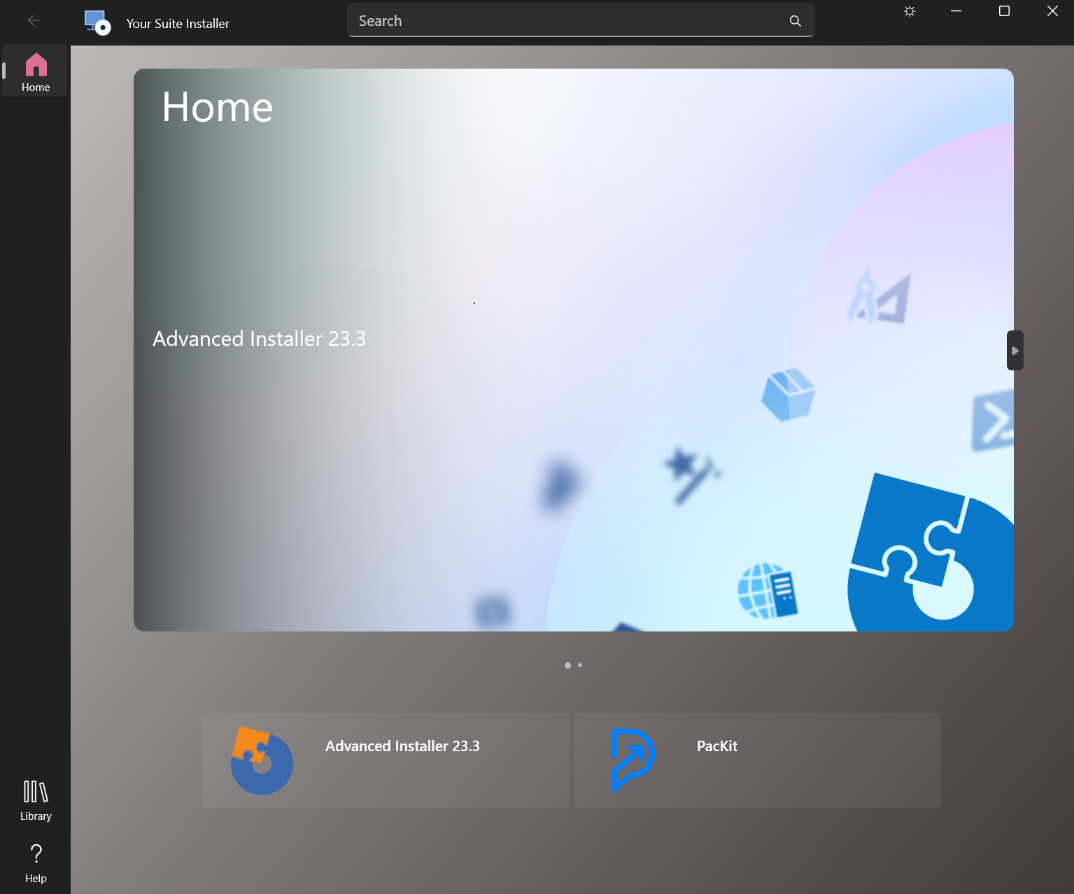

Once replaced, simply build the project to generate the installer for the Suite Installer app and run it. Your new custom theme will now be displayed when the Suite Installer launches.
suite installer theme after customization
