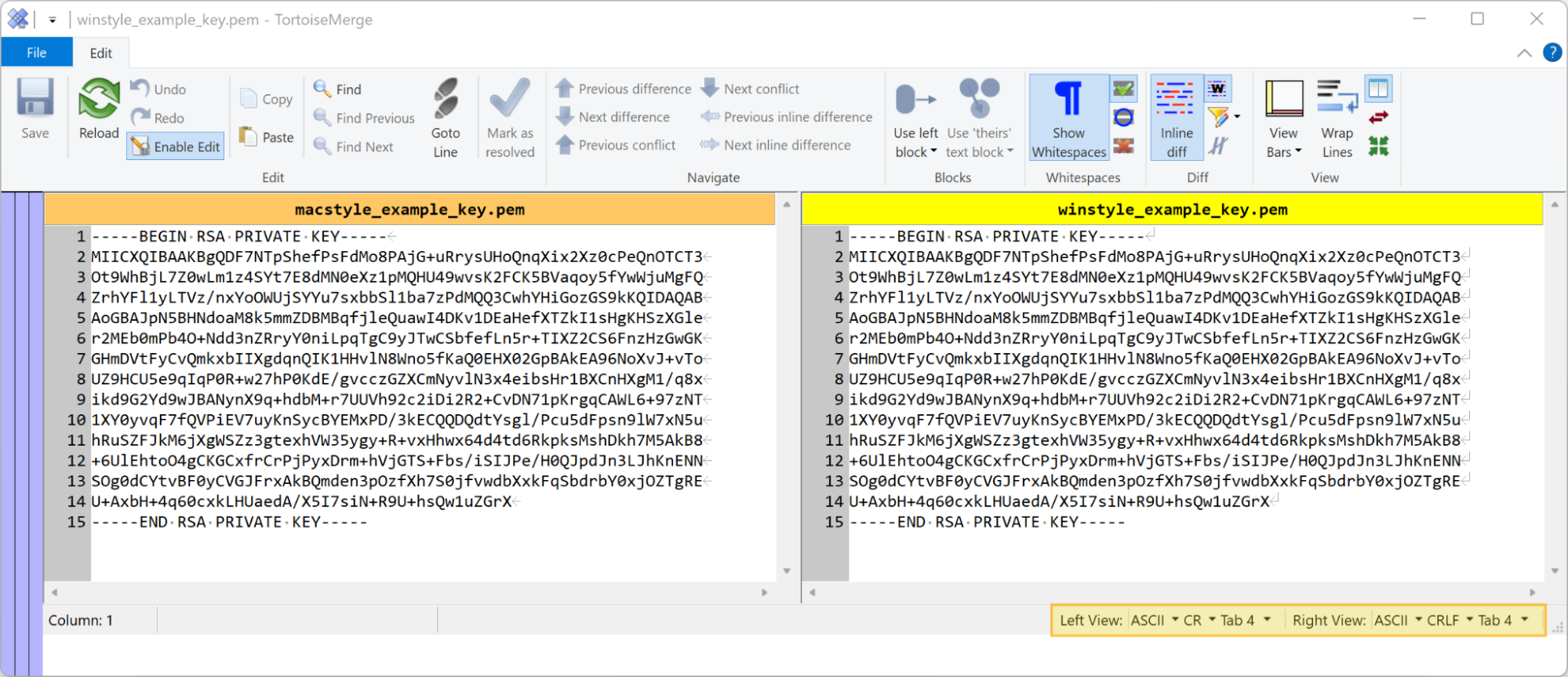

I was expecting that every line would end in 0D 0A (CRLF), but I was getting0D. In other words, the file had “Classic Mac” line endings (CR-only), leftover from some editor, or perhaps the user uploaded it from macOS without conversion.
Also, this was much clearer when checking the difference between the two files using dedicated tools.
The OpenSSH's PEM parser never saw the line breaks it needed to locate and decode the Base64 block. Why is that? Because the PEM parser on Windows only recognizes LF or CRLF as valid line markers.The result? A single giant line in memory, an immediate parse failure, and a stopped service.
