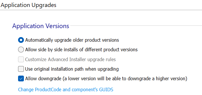

3. Allow users to downgrade from a higher version to a lower oneCopy link to this sectionLink to this section copied!
Since users will be able to swtich from one channel to another, we need to cover the case where the versions are different, and the user will move from a higher version to a lower one.
In the Upgrades view enable the "Allow downgrade (a lower version will be able to downgrade a higher version)" option.
Allow downgrade

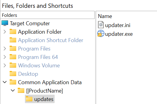

4. Customize Updater install pathCopy link to this sectionLink to this section copied!
Since the update channel can be changed e.g. from the application itself or manually by the end-user, we recommend using a location where no admin privileges are required to update the ini file that contains the URL where the Updater.exe will check for updates.
