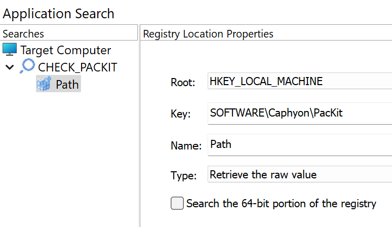

3.1 Add Registry Search
Let's say that we want to prevent the installation if a certain registry is not found on the machine. For this, we can add a registry search operation in the Search view.
Lets use the [ New Search Wizard ] toolbar button to define a new search following step-by-step directions.
Let's search for the following registry key:
HKEY_LOCAL_MACHINE\SOFTWARE\Caphyon\PacKit
If the above registry is not present, then the installation should abort.
This is how the search properties look like:

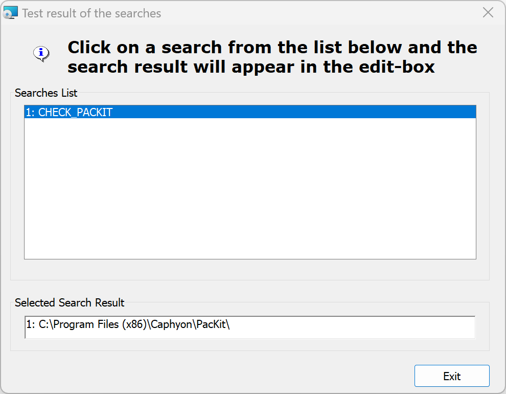

We also have the option to test the search as the setup would run on our machine:
Because the registry is present on my machine, the installation should be successful, showing the install location for PacKit. Retrieving the installation path for a software is crucial. For instance, you may need this information to install a specific add-in, update a configuration file, or load an extension that is part of the software installation.

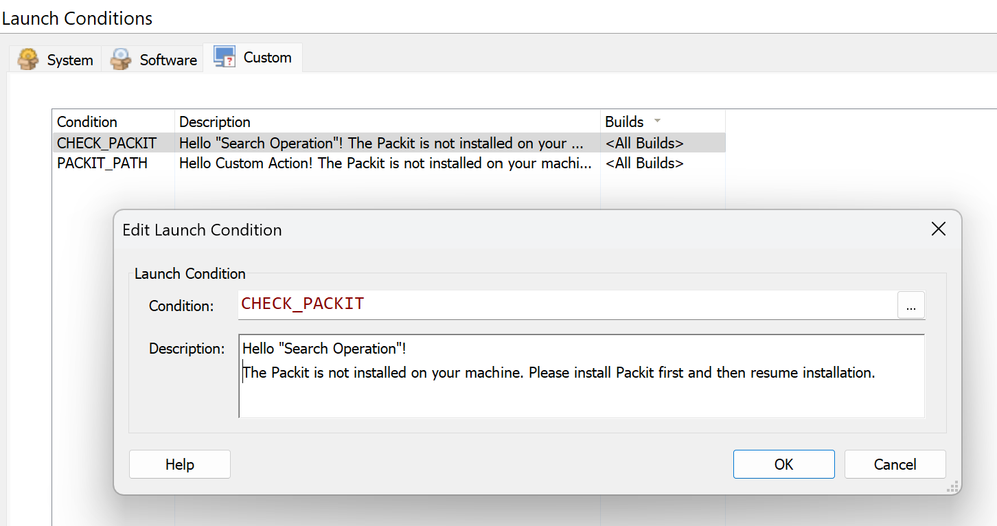

4. Prevent installation using a custom launch conditions
So far we've added the support in the installer to search for the related registry key either using the predefined search or through a custom action when we have a more particular scenario.
Let's configure the installer to abort installation if the registry key is not found on the machine. In the custom launch conditions tab you can define the launch conditions to prevent the installation in case the registry is not found on the machine:
The condition will be evaluated to false if the property attached to the search operation is empty e.g. the registry does not exist.

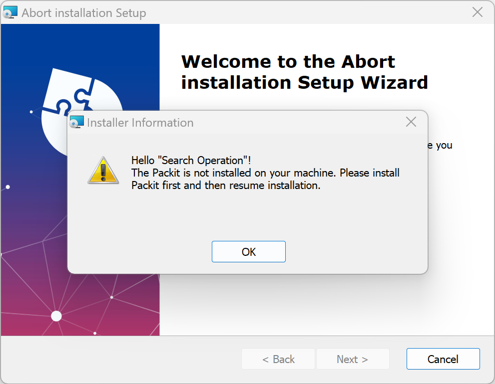

5. Build and install
If you build and run the package on a machine where the Packit software is not installed, the launch condition will be fired preventing from installing the software:
